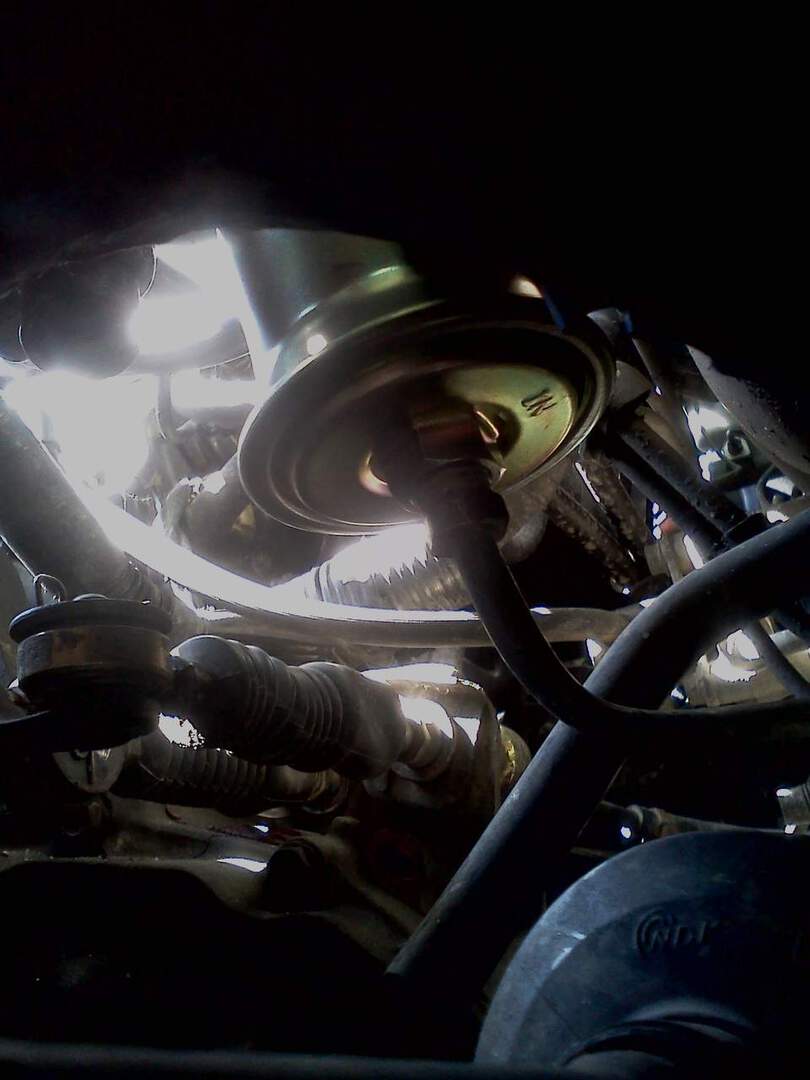

1-Remove fuel hose at bottom of the fuel filter. 14mm nut

2-Remove fuel filter holder at the side of the body. 10mm nut

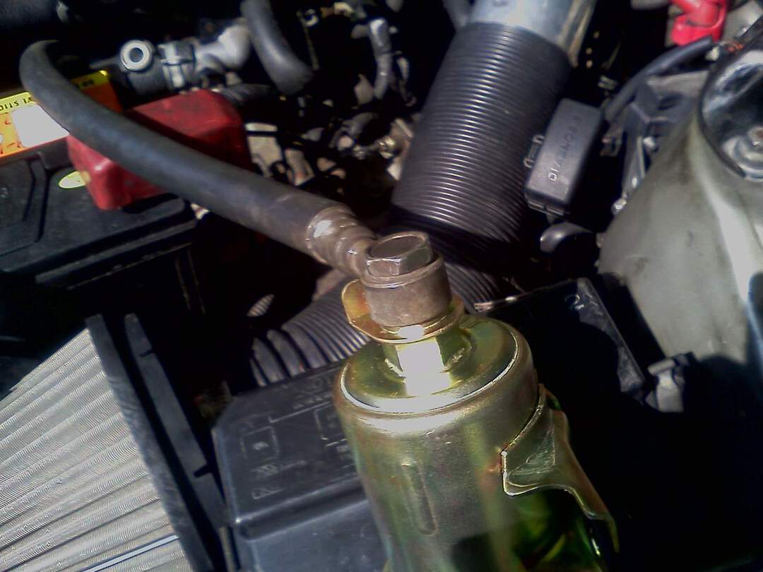

3-Remove fuel hose at top of the filter. 17mm nut

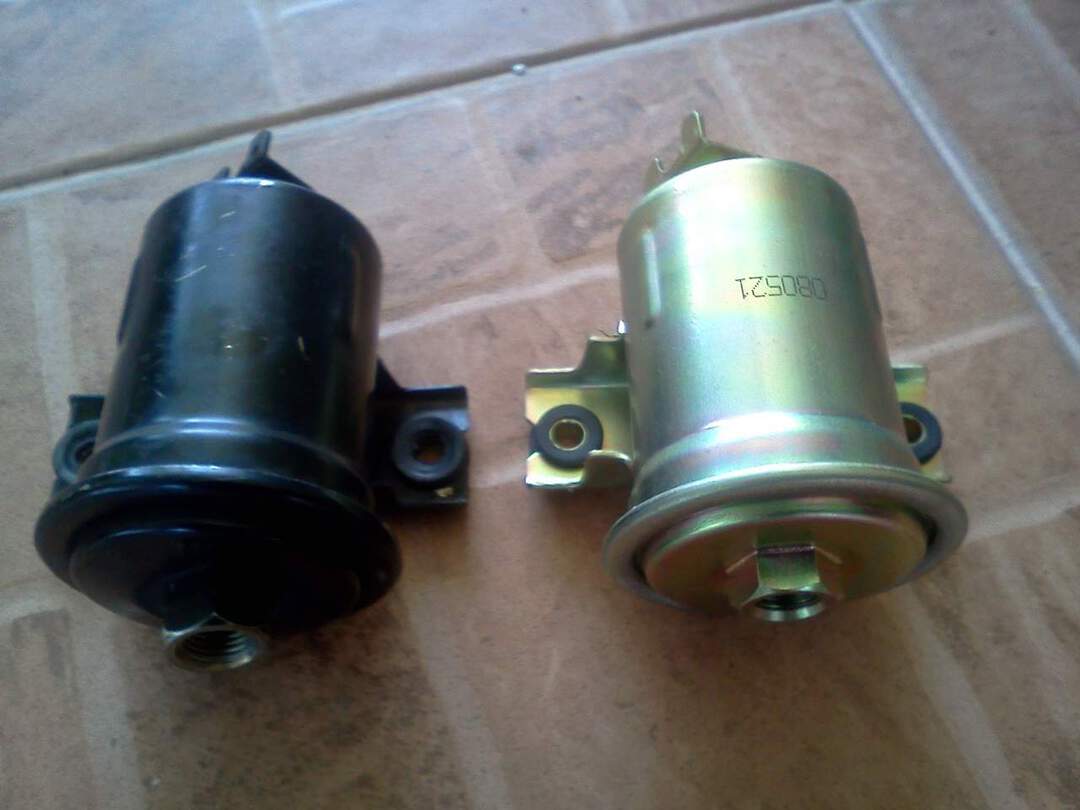

4-As we can see here yellow Ron95 petrol has turn to black and maybe clogged injector too.
attachment.php
5-New fuel filter on the left.
attachment.php
6-New filter on the right.
