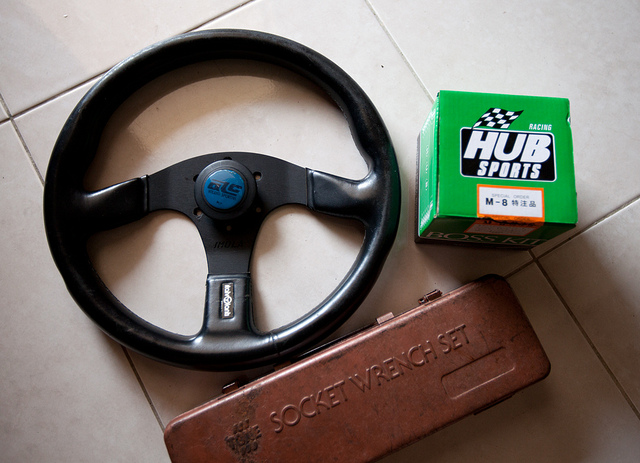

In episode #2 of Izso's Mythbusters, I'm going to explore the horror stories of the "Aftermarket steering wheel terror" where the bosskit or steering wheel itself breaks off!
It's not common to hear about these sort of breakages but they do happen and I was curious. And it was cheap. What's even more scary is a lot of people actually do this : buy a aftermarket bosskit, get him/herself an aftermarket steering wheel and install it. Ever so occasionally you hear the horror story of someone's steering wheel breaking off for no apparent reason.
So this article is going to be a 2-in-1. DIY install bosskit and steering and a mythbuster!
http://farm8.staticflickr.com/7196/6844098488_54c8a7a73a_z.jpg​
What everyone these days do is buy a cheap steering wheel (or half cut one) off your friendly local auction site or off a friend and that's exactly what I did for RM150. The HKB brand steering adaptor or bosskit is brand new off the shelf for RM25. All I needed was my trusty tool box and I got to work.
