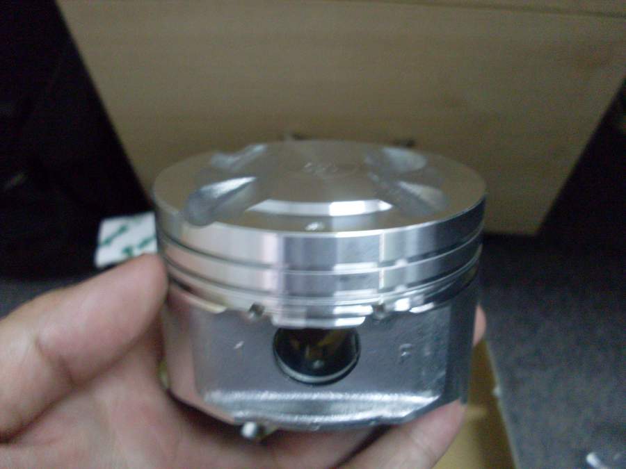

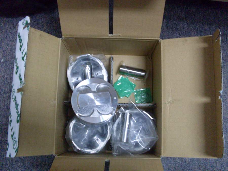

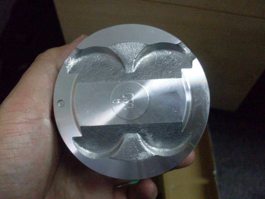

my brand new 84mm..
havent send to machine shop yet...
shinny :love:
