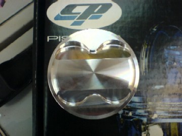

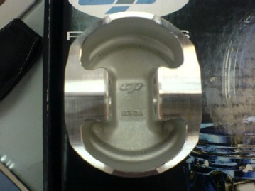

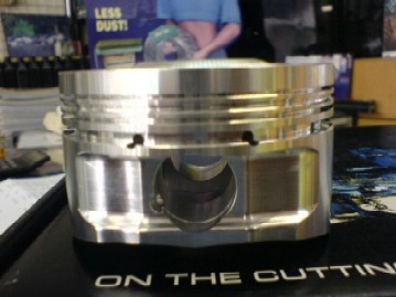

CP Forged Piston 85mm 11.5:1 (might be changing this for higher comp)

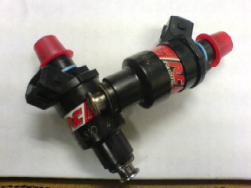

My slightly used RC Engineering Injectors 310cc
http://i80.photobucket.com/albums/j178/thtan777/RC310.jpg

Nice.. how much are these for a set nowdays? though personally I think that it's rather small for a 2L setup, since there's not much leeway for more fuelling as revs climb, if you're running more than 8K. It's just an opinion though, but I think whoever tunes your ride will know if it's adequate or not based on the A/F ratio.
True based on the Matsalleh formula.. But i seen B16A race engine tuned on stock CTR 240cc injectors with only 255lph fuel pump tuned to 200bhp with Hondata and it still works though if you check the injector duty cycle its already over 100% duty.
Another B18C-R with TODA C, again shows max injector duty cycle by 8000rpm but could still tune to a fairly rich A/F of 12.5.
Very strange my findings but its true.
310cc injectors was bought by mistake actually. Should have went for 370cc or even 440cc so got more room to play.. Regretted lio :mouth_closed: So will see how when the build is finish and ready to tune..

Actually it will run, that's for sure.. but for how long is the question.... I checked some spray pattern vids. I forgot where, but it clearly showed that the honda stock 240cc injectors can run 100%, but after a few secs, it started sputtering fuel.
However, if 104% duty cycle at 8K/9K, where your rev limit is at, I think it'll probably work... just don't maintain it there for long.
Anyway, can bump fuel pressure to compensate for lack of cc size, but after one stage, it will start to sputter.. I think that's what you're seeing for the B16A race engine, high rail pressures to compensate for injector's size... anyway the B16A engine is quite hardy, amazingly.. I can run quite lean and still not blow the engine... (high rod ratio perhaps? it's at 1.74) In fact, I was at 20K mileage when I finally decided that I had to do something about it... first went in VAFC, and then when someone offered good price for it, I swapped in an ITR regulator. Bad low end, and I get the rich fuel, low end exhaust sputter now and again, but the high end pretty much works out well.

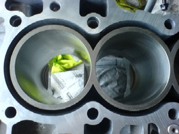

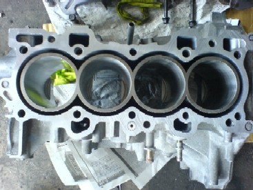

Sleeved Block
For bigger pictures and higher res then go:-
http://i80.photobucket.com/albums/j178/thtan777/Topview.jpg
http://i80.photobucket.com/albums/j178/thtan777/Sleevecloseview.jpg
Oit! this one looks like it's a local job.. where's the block guard? isn't it supposed to be epoxied to the sleeves? Or is it using the 'posting' method (I have heard and seen it on matsalleh setups, but not malaysians..)
I think it's a local job though.. is it?'
If it is, it sure looks well done...
It's been sleeved overseas with iron sleeves. After the 85mm bore u see in picture, the thicknesss of sleeves are still 6mm with the center between bores at about 5mm. It is an open deck sleeves like OEM just only much thicker and without aluminium surroundings. Can't fit the std block guard as the water jacket is too small and i don't think it need one now.
The block brace has also been machine fitted by them for this block and bore and hone there too. But might still need a final polish locally here to get the proper piston to wall clearance.
