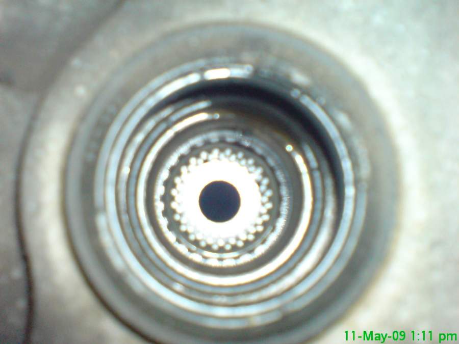

Gear box with LSD cannot see a metal piece in that hole. I normally use Redline. Rain using LSD is a nightmare + using Neouva Advan Yokohama. But dry on tarmac, muahhahaha. Poison on your right foot!

Yes, hard to determine LSD unless you look through the driveshaft center hole or completely dismantle the differential.
