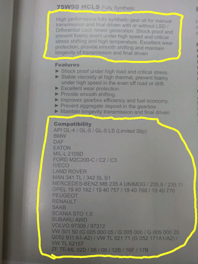

how can i be sure which oil is the correct one for the C56 LSD? can anyone who has a C56 LSD share some info about that? some posts about LSD gearbox say that using normal gearbox oil with LSD gearbox can damage it!
Hi, hope this can help. U may search on the bottle, boxes or catalog for specification.
*Specification taken from VOLTRONIC 75W90 HCLS Fully Synthetic:)
So u may use it with/without LSD! Hassle free!!
Unless you're using a clutch type LSD which requires friction modifier substance in the transmission fluid, else you will be needing only normal transmission fluid for gear type/helical/torsen LSD.
