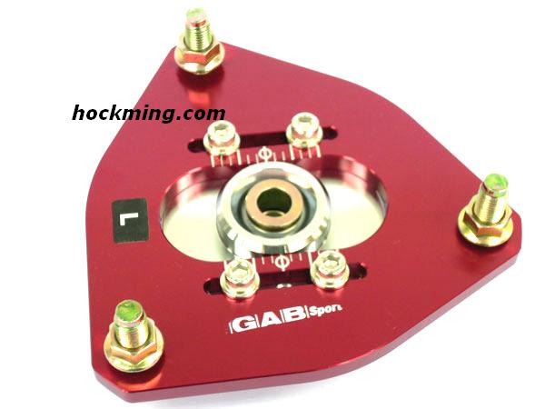

btw anyone have idea whether we can use aftermarket front pillow ball mount for normal kayaba absorber ? eg: GAB or Tein..
Hey jackylsp,
The GAB pillow mount photo you taken is from hock ming from Seremban?
Is it brand new & locally make one? Suitable to any car & whats the price like for front 1 pair?
