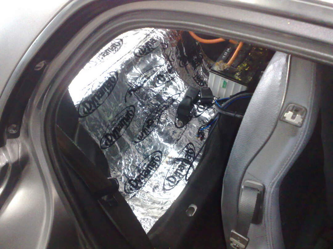

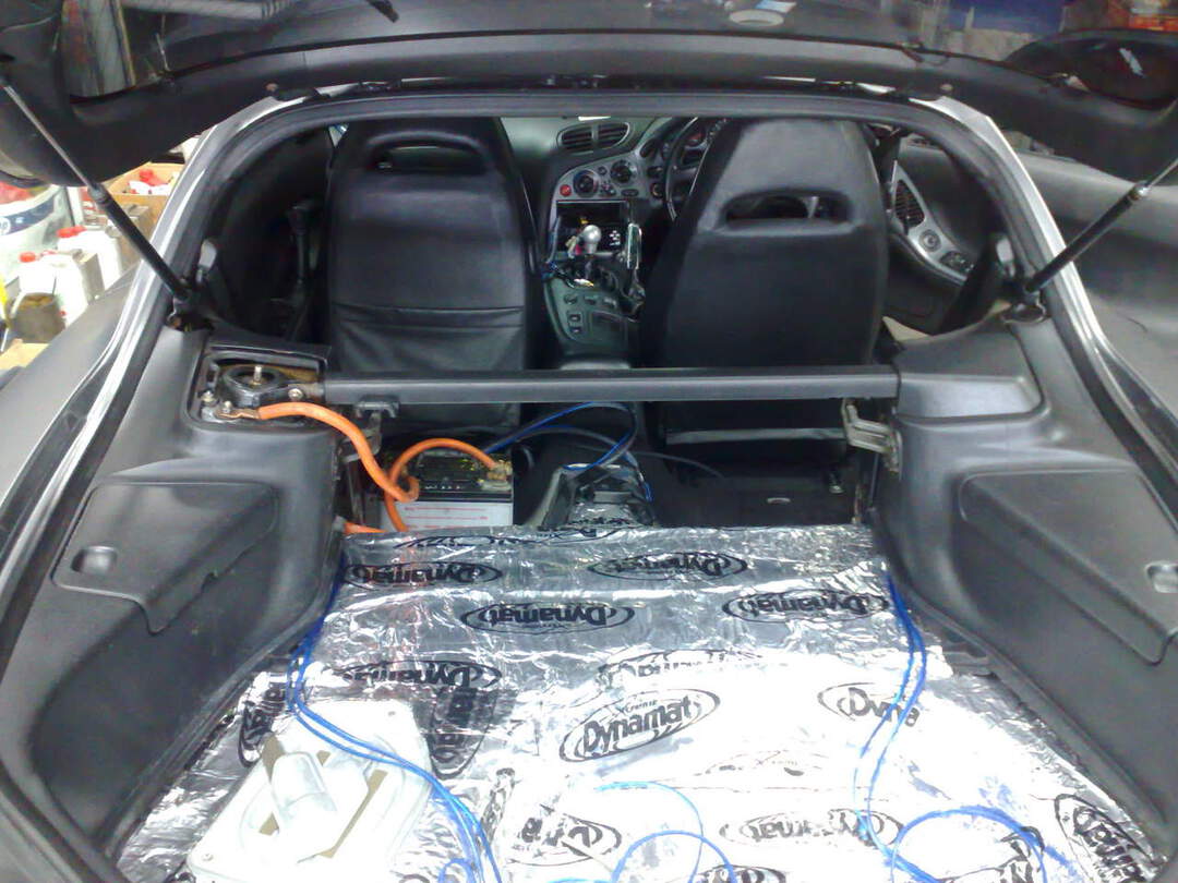

agreed with elsm80, i've done my car with sound dampening (rear seats, both doors and rear boot). i do not expect significant effect but im happy with the noise reduction after i installed it, i got about 10-15% noise reduction. FYI, im using 3" straight pipe.
Doors are heavier than before due the sound proof tap are not light, i installed 2 layers for each door and right now the bottom of the doors is damaging my door steps and side skirts because the door "sink" down a little bit due the extra weight added to the door. Any way to solve it?

hi bro malimsiao, I guess you have over did your car door... That's why it is heavier than it should be. May I know what do you mean by double layer/2 layers? You mean layer on layer?
If you wish to reduce further on the sound of the rear, you can try applying insulflex on the board that covers the boot floor...(Cheaper way).
Or you can try using HoodLiner on the board, it is open cell materials and meant for sound reduction. (No element of advert :P, but hope it will help you reduce the noise further.)
