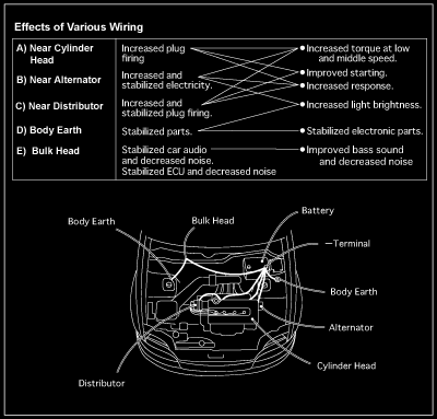

can some1 pls comment the grounding points for this diagram? can remember from with website....... :confused:
