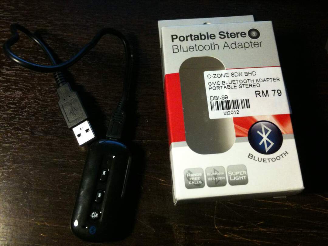

  2. Some cheap bluetooth adapter from computer hardware shop (this came with internal mic, skip track, call button, internal 200mAh battery and micro usb cable for charging. But i'll skip the control features as i'm gonna control everything from my device).

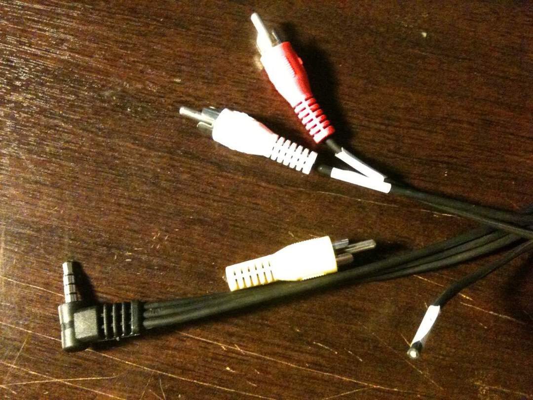

  4. 3.5 stereo jack/rca cable (it came with 3 split cable, which the yellow rca will go to video, but in this case i'll divert this to ground connection from my car stereo).

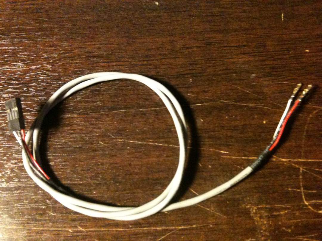

  2. AUX cable for my stereo. I've cut out the rca's end, spliced and shell the end tip with some pin connector (from my old floppy drive cable), which will fits nicely on my car stereo's AUX line.

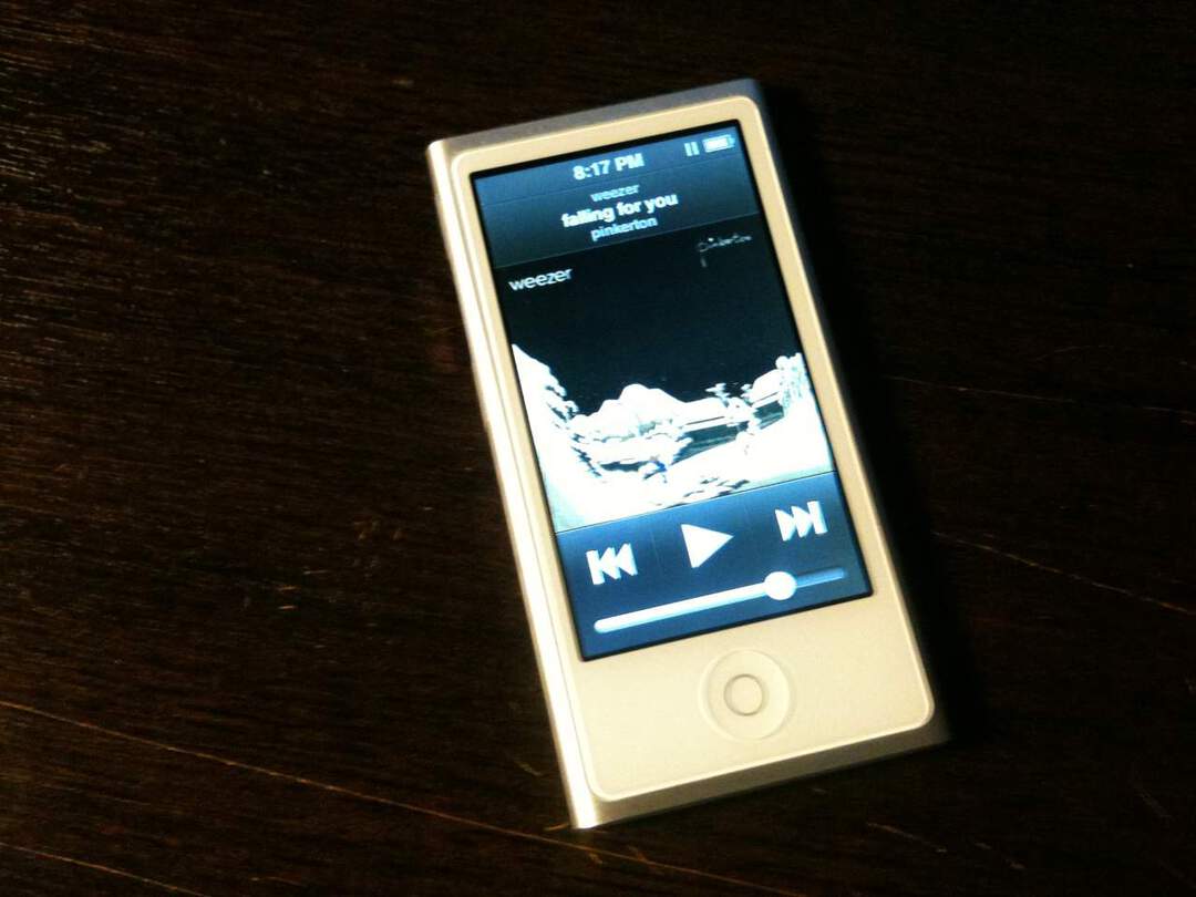

  • ipod nano
  • bluetooth adapter packaging

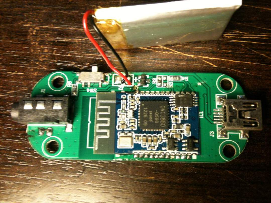

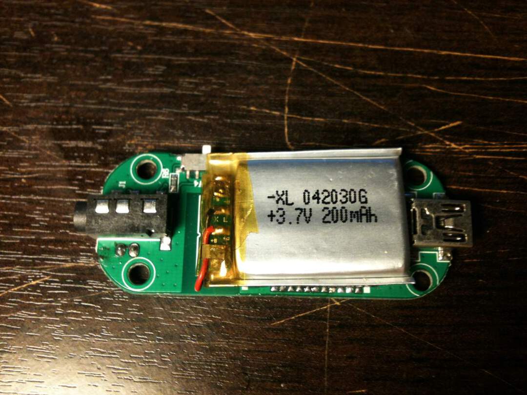

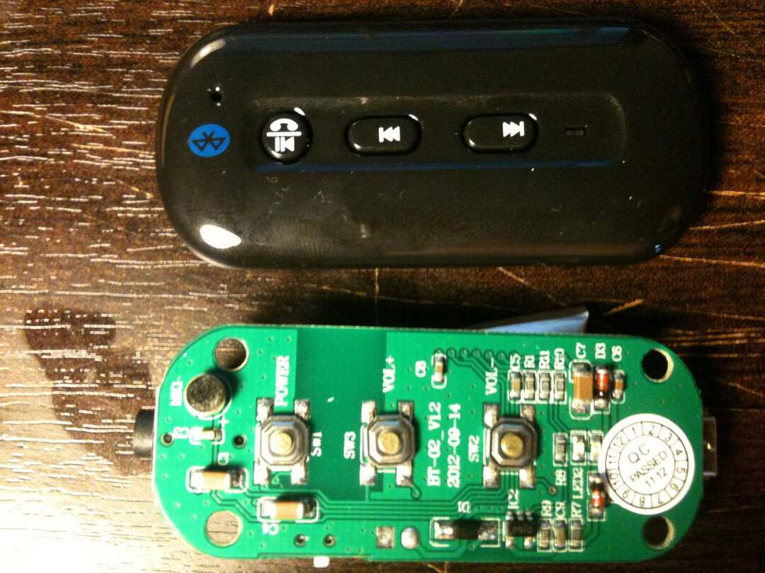

  • teardown - controller face
  • teardown - battery face
  • teardown - rear pcbs
  • 3.5 audio jack/rca
  • old floppy drive cable
