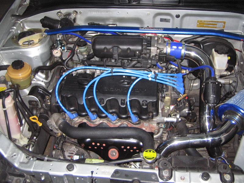

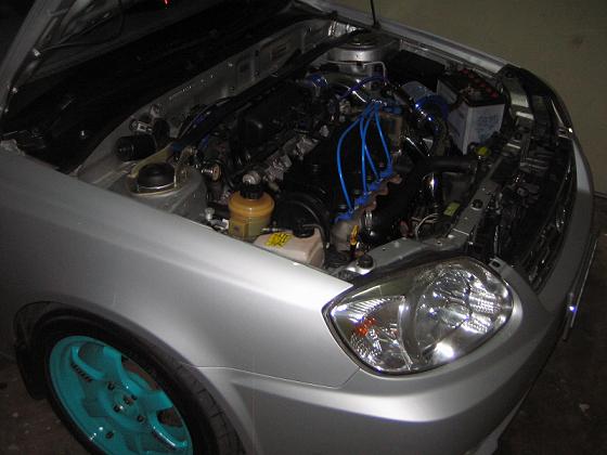

if u like to play frm bottom wit internal stock can but whp not so high but due to fun n reliable BOt is my choice. if u said bigger whp ????the bigger than more $$$$ to spent n this is the same as bot just calculation of whp is the diff. 4 me ive done 2 projct on tis car 1. Convertion GSR Ck in it ...2. BOT just done whp Not much diff.. GSR CK Stock HP170 my BOT hp 150. one more thing is JPJ endorse n More $$$$$.....seee it to believe it
