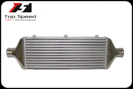

below the colourful picture is turbocharged engine, the cute black thingy is the TRD toyota racing development Supercharger...can come in many types and shapes...same goes to turbocharger snail...^_^.....the snail like figure object is what ppl know as turbo turbine ^_^....the long board with filter look alike is intercooler ^_^

When you saw intercooler at the bumper there sure is TURBO..
That day I saw a kancil at Sunway. Front mounted IC. Open the bonet, it's not connected. That day i saw a Subaru and RX-7 racing. both can't see intercooler. Open the hood only can la... one top mount, one is V mount. Open the hood sure can see. But has to be connected.
