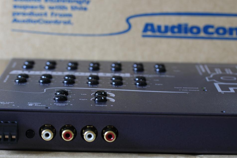

It's best to add a good processor with high-level inputs (speaker level signal, which can be taken from your front or rear speaker terminals) to recondition the signal and remove unwanted noises before it's translated to low-level RCA outputs to your amplifier. This prevents damage to your equipment in the long run, as well as ease your ears of noise and bad signal. Garbage in your amp, and amplified garbage out to the speakers.
Go for a good condition used AudioControl EQL concert series , made in USA - rm700 (a new one is rm1200-1500).
