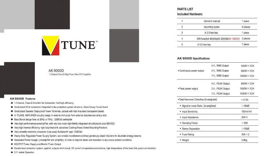

2. V -TUNE AK9000D MONOBLOCK AMP (GOT PIC)

sub is dvc 4 ohm 650W rms
u need an amp that can give at least 600W rms at 2ohm (your sub has to be wired in parallel)
parallel wiring diagram here:
http://www.the12volt.com/12voltimages/1_4ohm_dvc_2ohm.gif
not all 2ch amps cant go down to 2ohm in bridged mono mode
look for monoblock that can give at least 300W @ 4ohm or 600W @ 2ohm
