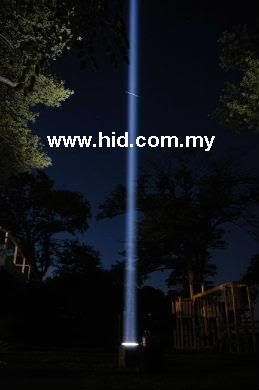

Below is my 8000k touch light pic. if i use 4300k or 6000k (shorter wave lenght colour) touch, u can't see the line.
PM i tell u some secret abt the rebrand/repacking kit. :)

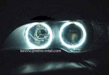

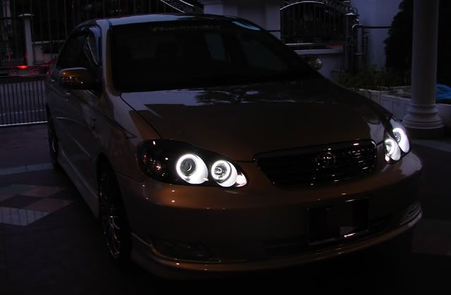

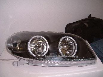

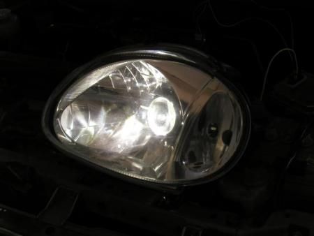

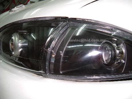

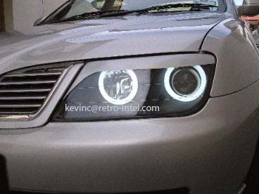

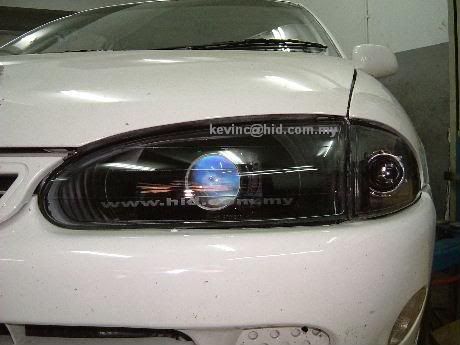

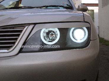

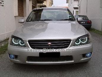

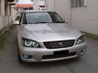

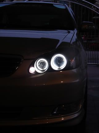

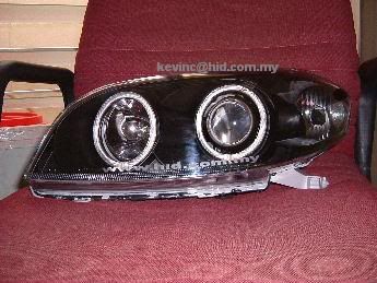

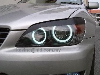

Toyota Altis Retrofit":
Toyota Altezza Retrofit :
j

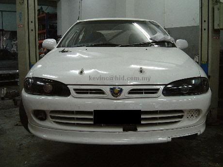

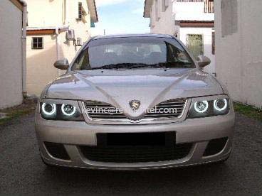

Waja retrofit from H1 projector to D2S projector.
E46 Vs Waja

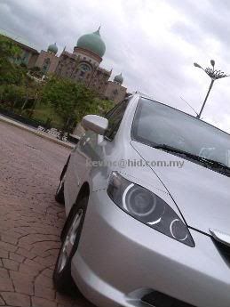

Toyota Vios retrofit :
