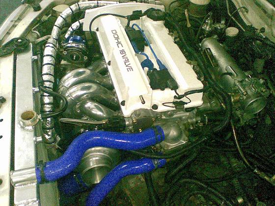

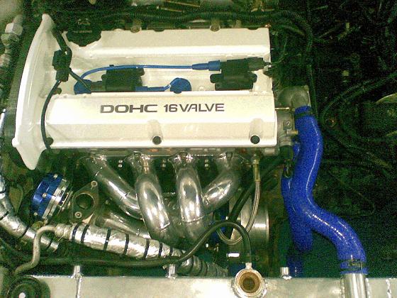

Easy for upgrade your engine from Carby to injection.NA to Turbo.Engine Lantai plug and tune with Sprint 500.And Low budget.Like im doing in my workshop,
1.ECU Haltech 500
2.Engine lantai Overhoul,new metal gasket,new engine and rod bearing and seal.
3.Installation and tuning
4.Wshop labour
Basic Starting from RM5000 for NA.RM8,000 for Turbo
