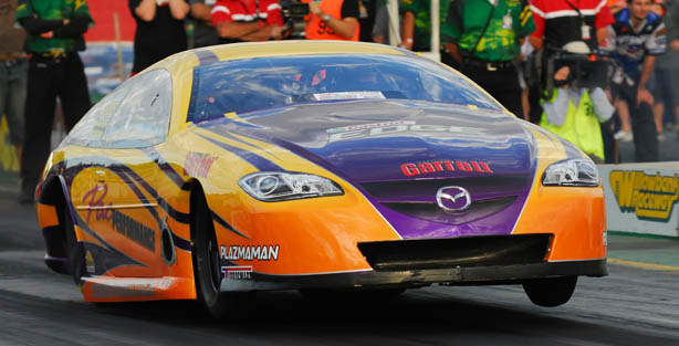

Haltech is proud to announce its partnership with Pac Performance’s racing team. After extensive private testing their Pro RWD Mazda 6’s engine management requirements is now handled by a Platinum Sport 2000 ECU paired with a Haltech Racepak IQ3 Logger Dash to cover its extensive data acquisition needs.
The PAC Performance Mazda 6 is a the current World Record Holder for both the fastest and quickest rotary car and the PAC Team are keen to hold on to that title and indeed try to get the car deeper into the sixes! The team is also looking forward to taking on their Puerto Rican rivals, renowned for their consistency and speed.
Note:PAC change Microtech ECU to Platinum 2000 on this jamboree 2010

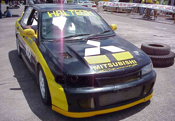

This unibody Evolution was the first to ever run a 9.6 second time of pure terror around Vernamfield without the help of NOS. The Evo has the record for” Standing 4 cylinder” at Vernamfield, Jamaica and has held it for 3 years.
The Evo is packing a Haltech ECU and running 28psi of boost on a T88 turbo and putting down 600hp to the wheels still using the standard RS gearbox and drivetrain. The car has been built by Henry Williamson and owned and driven by George Bayley. Horatio Williams from Advanced Technologies tunes the Evo and Gina Bayley is their major sponsor.
Noto:News from Haltech
