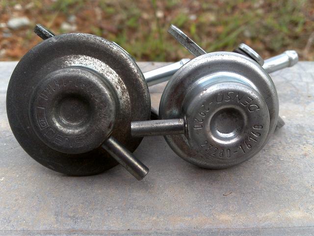

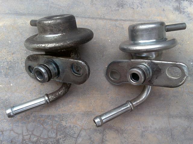

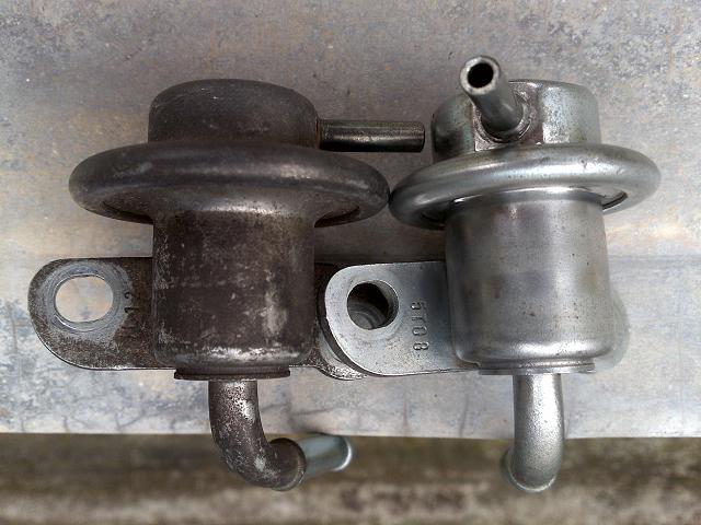

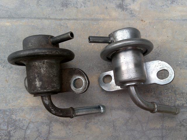

I have search thro' the net and found that all info from the blogs and forum stated that SVT and BT's is sharing same fuel regulator, that is 23280-16140. In fact, this is misleading.
The fuel regulator use for SVT and BT are actually different in shape and part number.
SVT's - 23280-16140
BT's - 23280-16160
However, i have never test out the pressure. Perhaps some one can input?

Ah ha...Good info...
and I believed some of them notice that SVT's FR was infact a bit bigger...
so they decide...
"hey...SVT FR much more bigger...bigger means more power...let use that one..." eqeqeqqqeq...
but then ...getting the pressure range between both model would be useful info...since we're lacking of tech info... :D
BTW...in my blog, I didn't mentioned any of SVT n BT FR part number...just stated there, that 23280-16140 is interchangeable...(still using SVT FR...ignoring BT FR...hmmm...does size matters ?? )
i'm using BT regulator for my SVT (to replace AFR), i believe the pressure was the same. I'll check again the figure. In term of power/fuel save - both at the same level.

For you information, the both actuator was set the fuel pressure at 2.55 kg/cm2... Hence both are the same thing only.

But why with the different in part number... ?
It might or might not be the same...
I guess part numbar diff is because they have diff in shape.
BT's is always a cost down version from SVT's. They reduce the size of the FPR's head by removing unnecessary materials fr the SVT's. Since the body diameter is same, hence i believe both using same spring inside and deliver similar fuel pressure.

When any parts have different shape,size,dimensions,spec...usually manufacturers will give different part numbers
