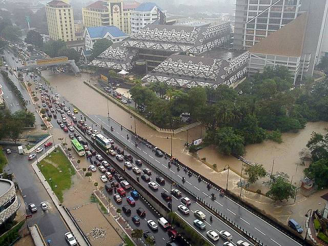

In light of recent events, I thought it'd be prudent to talk about flooding and how it affects us - the motorheads.
Generally speaking, water + engine = BAD
Not referring to those water/methanol injection kits, those inject very small amounts of water into the intake and usually as a mist. I'm talking about copious amounts of water that seep into your engine bay through your cold air intake (CAI) or through vents on your hood or fenders. Or worse, if the water seeps into your cabin!
Multiple things could happen if your car get flooded or is driven in flooded areas.
