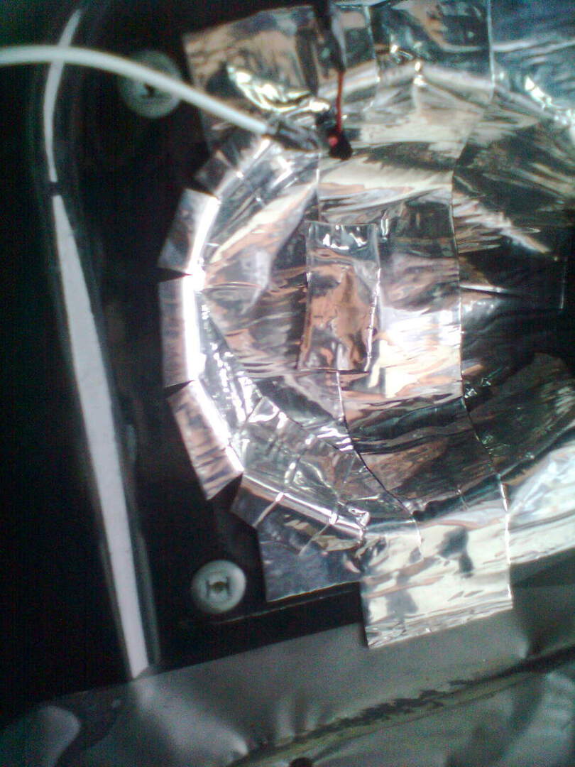

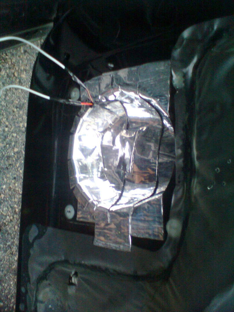

i also having the same problem after raining...if u a proton user...keep in mind if u did change your door speaker...make sure ask the shop to seal the speaker hole

i think all cars also have hole for speakers rite? unless u like the speaker and the magnet to be installed outside....new fashion?
yeah it right...but proton cars have some plastic casing that fits the speaker...it protect the speaker from been wet by raining...other speaker didnt fit into the casing...
oic...but other speaker also when u remove it also got hole rite?
