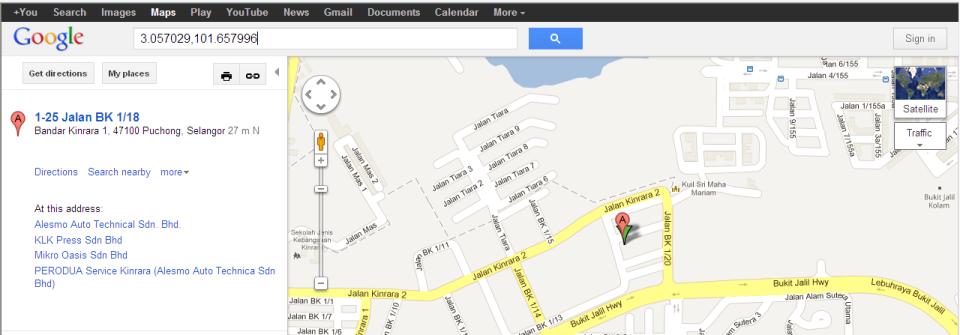

Ah Wah's workshop location @ Kinrara
GPS Coordinate : 3.057029,101.657996
