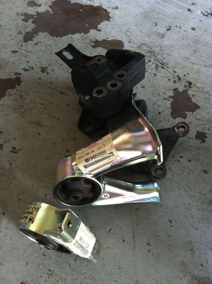

Anyway, it's time to get this problem resolved. For those who had this done before, you know that it's not cheap. The new original mountings + labor easily reaches RM1.7K. So I had it done. Pictures as shared below:
The new engine mountings.

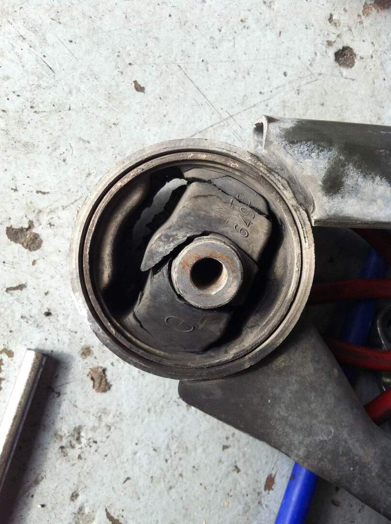

Damaged old mountings. Hmm.. no wonder the vibration is bad.

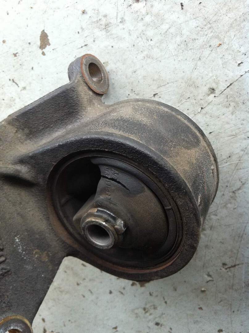

This one is severe.

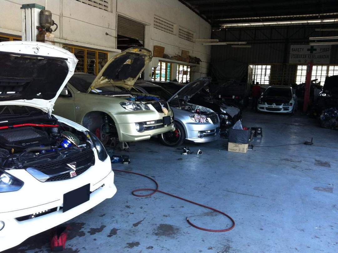

When I was at Ah Wah's workshop. 4 Airtrek Turbos, 1 Caldina GT4 and 2 Evo 8.

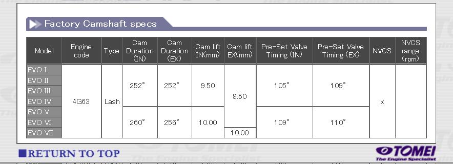

So far, I have NOT refueled yet as I've been driving only short distances. Based on the declining fuel guage, I think the FC has improved. Actually, I do not know the cam degree until you asked, I went to search and found the following.
attachment.php
anyone knows the cam degree of the stock cam?
Do take note that we CANNOT use the cams from Evo 9, coz the Mivec head & mechanism is different. So, only cams from Evo 4-8 are compatible with our Airtrek turbo yea =)
