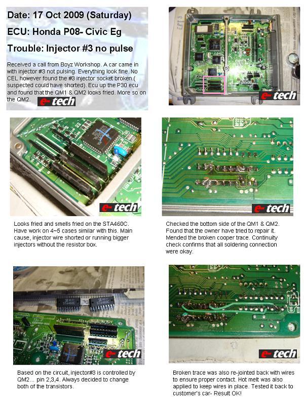

Honda ECU P08- No CEL Light. Injector #3 no pulse signal.
Car running like 3 cylinder.

hahaha.. is just same as ur pic ... my QM1 fired.. just go buy the chip and replace it only... hahaha
e-tech & stupiddog must very skill full... my hand shaking + sweating when touch this thing... :itsme:
aiyo.. no need skill la.... hahaha just make sure ur soldering the correct stuff...
