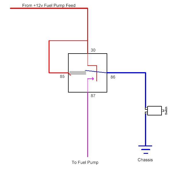

A relay could also be added to the Circuit if you are using a performance fuel Pump or if you prefer to be Extra Safe

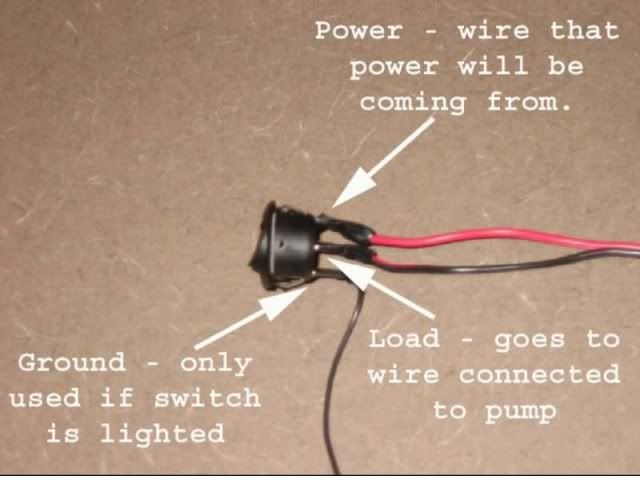

Before starting to cut wires on the car, prepare the switch.
Solder on the wire you will be using to the Switch and cut the wire to a length which is much longer than required , It can be snipped Later when everything is done. When wiring a non-lighted SPST (single pole single throw) switch, the top blade is typically the POWER side or LINE side, meaning that this is where you solder the wire that will be running from the 12V battery . The middle blade is the LOAD side of the switch. Which means this is where you would be wiring the side of the fuel pump wire that goes directly to the pump. Check out the picture to see what I am talking about. This picture shows a lighted switch (Not a Good Option ), but it's the same principal. The RED wire is what will be used for power, the BLACK wire is the one going to the fuel pump side

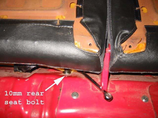

First we have to remove the bottom cushion of the back seat.
1. Lay the tops of seat down like you would if you were loading something in the car.(For Civic Only, Other Cars Establish where your Fuel Pump is and work from there)
2. Pull up the fabric that covers the spare tire. Pull it up enough so you can see the bottom of the back seats, like in this photo.
• Use your 10mm wrench on the single bolt in the back. It can be somewhat of a pain to get to.
• After you have that bolt removed, pull the tops of the seat back up and get inside the car.
• Pull the cushion up by the front first. You will have to lift up and pull back, as there are little hooks holding the front of the cushion in.

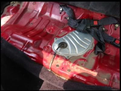

• After you are done you should see this:

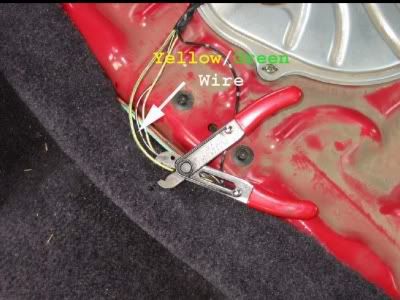

Now Comes the Cutting and splicing of the Wires to Connect the Switch
1. Pull the little bit of carpet back if you need to, and unwrap the wires.
2. Find the YELLOW wire with a GREEN stripe
3. Cut it where ever you like.

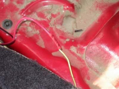

1. Strip about 10/15mm or a little more off the ends of the wires.
2. If you are using shrink-wrap, make sure to put in on now.
3. Insert the appropriate wires into the butt connectors (SOLDERING IS A BETTER OPTION) POWER wire goes to the part of the YEL/GRN wire running up front, LOAD wire goes to the YEL/GRN wire going to the pump.

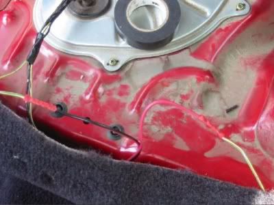

4. Then they will look like this:
If you wish to add a Relay , Use this Wiring Diagram to guide you through :
5. Now wrap up the connections neatly.

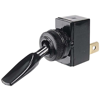

Thanks for the Post ,The switch you need to use / Buy is called a SPST ( Single Pole Single Throw ) Automotive Rocker Switch, Or a Toggle Switch , The Amperage that your Switch can handle will be Written somewhere on the Switch itself ( See attached Photo ) , It will state 25A or whatever the Load rating for that Switch is , Try not using a switch with a Lower Rating as that Could cause trouble. ( The Rocker Switches in the Picture are all 20A, Just for Reference sake, You will need a 25A, But if you are fitting a relay , Then a 20A would work too)
You can get relays at most Sound Fitment/Accessory/Spare parts Stores, ask for a standard bosch 5 pin relay. these are Great Quality relays and come with a pre wired plug that makes it easy to connect your car wires to, but You will only use 4 of the pins on the relay but usually the 5 pin version is more readily available and usually alot cheaper then the four pin version. On the 5 pin you will not be using the middle pin, Which is Numbered 87A if I recall correctly.
If you are Unsure , Get all the Correct Parts then Head to an Auto Electrical Store / Service Centre and have them Wire up the Switch for you , If you Supply all the Hardware it Should take no Longer than 20 Mins to Connect the Switch and Should not cost more than RM30.00, This May save you alot of time
