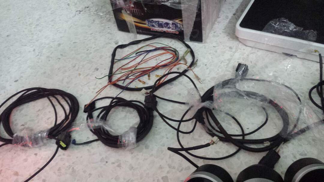

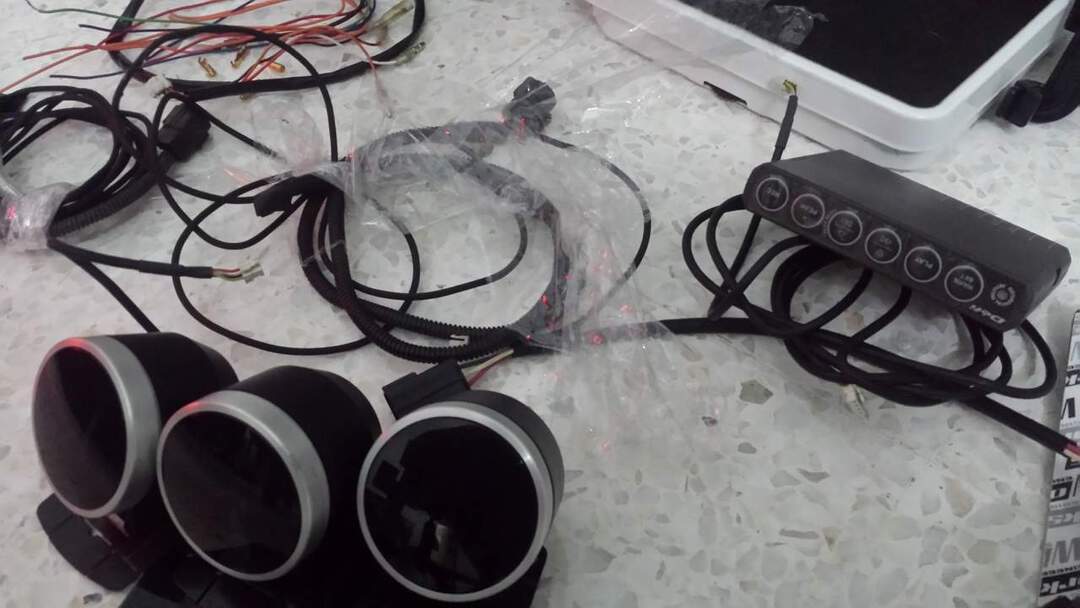

Attached below, will be the kit, sensors, adaptors and prepping.

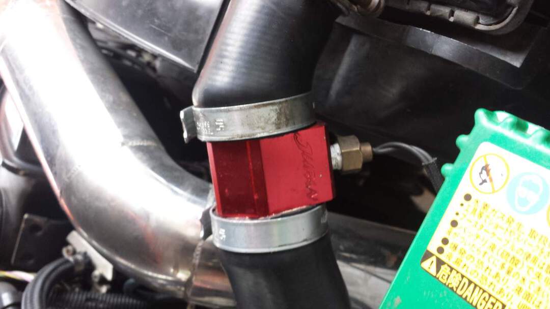

Water Temp Adaptor
Sensor adaptor installation. This part not much photos can be taken, cause your hands will be quite dirty. So im gonna try to explain the best i can.
Water temp adaptor quite easy. In You will want to remove you radiator hose, before the thermostat. In my case bottom hose is connected to thermostat. So installation will be done on top hose.
Look at your hose and try to locate the best location for your adaptor to be installed. You can either mark the spot or eyeball it, remove your top hose by undoing the 2 clamps. Cut the hoses with sharp blade such as box cutter and attach your adaptor (sensor at the bottom as shown in pic). Water will flow through the sensor. If you install with the sensor on top... And if water flow is low, water might not touch the sensor fully and readings might be very inaccurate.
Clamp the adaptor with your new hose clamps, and refit your hose back to the radiator.

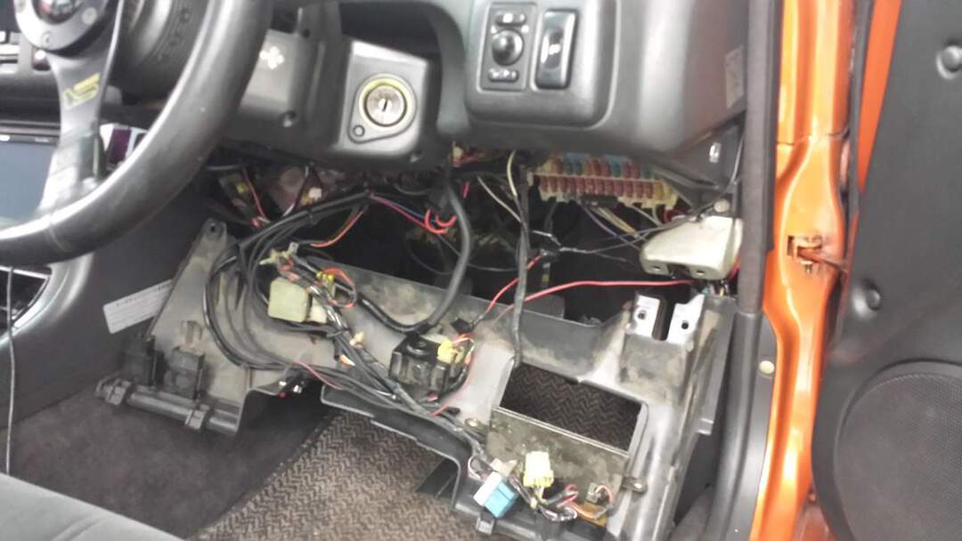

Interior wiring.
Constant 12v - Red Wire on controller.
With your tester look for the contant 12v signal, if you alr have any existing gadgest installed such as alarm, ebc, turbo timer, audio player etc this would be easy for you. If you dont, you can find one easily as well from the ignition wiring harness with your tester. If you're unsure of this just ask, will try to guide you or if you have your wiring diagram layout for your car you can follow that diagram for this source.
Ignition / Switch - Orange wire on controller
With your tester, you will want to find the wire that gives you 12v signal when key is turned to ign and no signal when key is off.
Illuminination - White wire on controller
This you need to source normally from the lighting side of your steering/ignition wiring harness , AC dash panel or your audio wiring loom. On audio side, illum normally is the orange wire. For ac or ign wiring loom, it depends on car to car. If you are testing for a fresh source, all you need to do is use your tester poke into the wiring loom socket, look for a 12v signal when you switch your light on. Basically on that same wire, there will be a 12v signal when light on and no signal when light off.
Ground - Black wire on controller.
This you can pretty much ground to any part that is already used as grounding. So can locate any exisiting ground spot or use a new one convenient to your controller location.
Once you have gotten the source for this 4 wires, splice into them. Use the additional wires which you have, the length depends on your location of the controller, colour is up to you.
you can either solder, crimp or just twist and tie, dont forget to wrap them well with quality wiring tape aka black tape one end of the wire to your car wiring. At the other end, you are going to attach the connectors. Attached below is where the female x 1 bullet connector and 3 male bullet connector will be used.
In this pic, is the defi controller wiring harness
In this pic, is my wiring which i pulled from the car. In my case i used

Ground - Black Wire - attached a male connector at 1 end, and at the other end you will want to connect the terminal lug attached below.
Terminal Lug for ground wire at other end.
Ground the terminal lug to a bolt
You can either use rubber insulation on the connectors, heat shrinks, or just good ol wire tape on each of the connector. And this is where the optional wire loom can be added. Bottom will be attached how it all looks once you got your sources, with connectors installed and insulated.
Once you covered all of that, we can move on to connect the defi controller wiring harness.
This is after connecting the harness and adding the wiring loom to tidy up. Sorry this pic a bit blur, working alone with not so clean hands and trying to snap pics....with a white phone aint easy man. hahahah . The other end which im holding up is the white socket that will plug into the controller unit, into the DC SOURCE input.
Try to tidy up all your sensor wires, and the dc source wires, cable tie them and group them as neat as possible. So when next time if you gonna do any rewiring for other stuff, its not gonna look like a time bomb that needs to be defused.
So we have the power wiring setup done, we pulled all 3 sensor wiring through the firewall, time to connect all of it.
Water temp with blue socket goes into water temp input
Oil Temp white socket into oil temp input
Oil press black socket into oil press input
The wiring harness that connected to the car 12v etc goes into DC SOURCE input.
IMPORTANT
for BF gauges install in meter output 2, if you connect black face to output 1, it will only illuminate when headlight switched on.
If you you connect white face to output 2, it will illuminate the whole time
Now so your 3 gauges would be connected via link, then connect that meter output 2 harness to your gauge.
