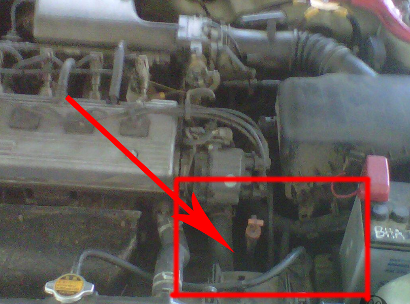

attachment.php
Bro, can you zoom into this section of the engine bay and shoot with a camera + flash? I can't see the gearbox from this pic

attachment.php
a bit bz bro at the moment.. will take pics asap ...thanks..
see below ur rad, got 2 hose , that is stock gb cooler line

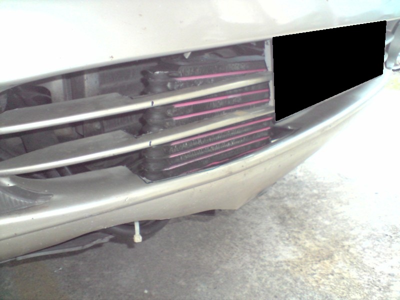

Shawida : When there's a will there's a way. Cut the bumper! :biggrin: I had to cut a bit off mine to allow air to flow through. Otherwise by default it was sealed off. And on my Wira I cut a bit too to allow it to move around a bit without banging my bumper
here i share u mine wit bumper cut to clear the oil cooler fan motor from hitting my a/c coil...
1)frontal view
2)fan+motor view from top
3)side bracket sharing from hood lock brace
4)roughly done due to time constrain..even the cooler senget abit...but now all rectified and aligned properly :driver:
p/s:my cooling fan wiring i use separate switch...(donwan to hook with radiator fan switch so i can freely keep the ATF extra cool on hot sunny dah jamm)

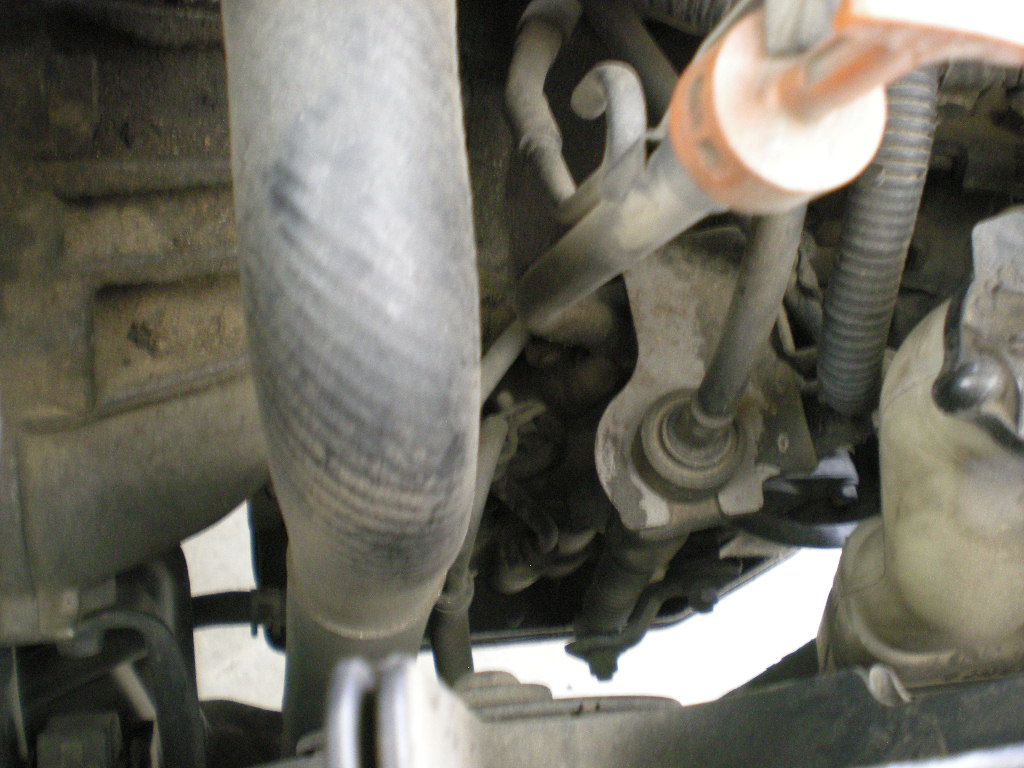

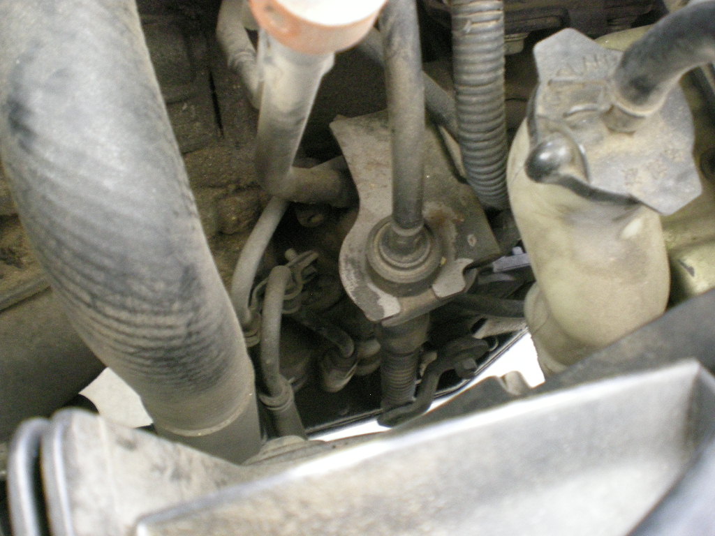

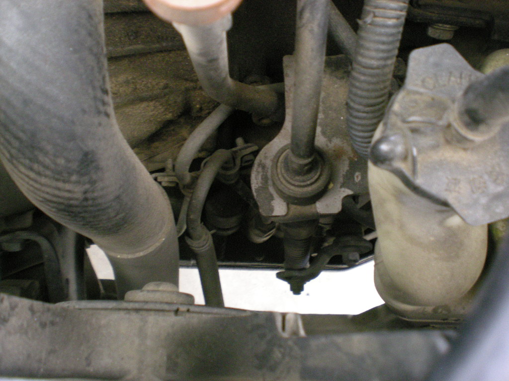

btw these are the pics that i took..sorry it took a long time..

Hmm... I can't really identify what I'm looking at. If those are the hoses coming out from the GB, then yes - that's your ATF hose that you'd want to use to install the cooler.
Hi Shamblur,
the 2 slim hoses next to the radiator pipe is the ATF gearbox hoses which runs to the radiator.
There is a way to connect the oil cooler not sure better or worst ...
Install the atf oil cooler between the radiator and gearbox.
1 pipe to radiator, radiator 1 pipe to atf cooler, atf cooler 1 pipe back to gearbox ...
can consider this setup ... some pple jus totally ignore the radiator and use the atf cooler only ...
