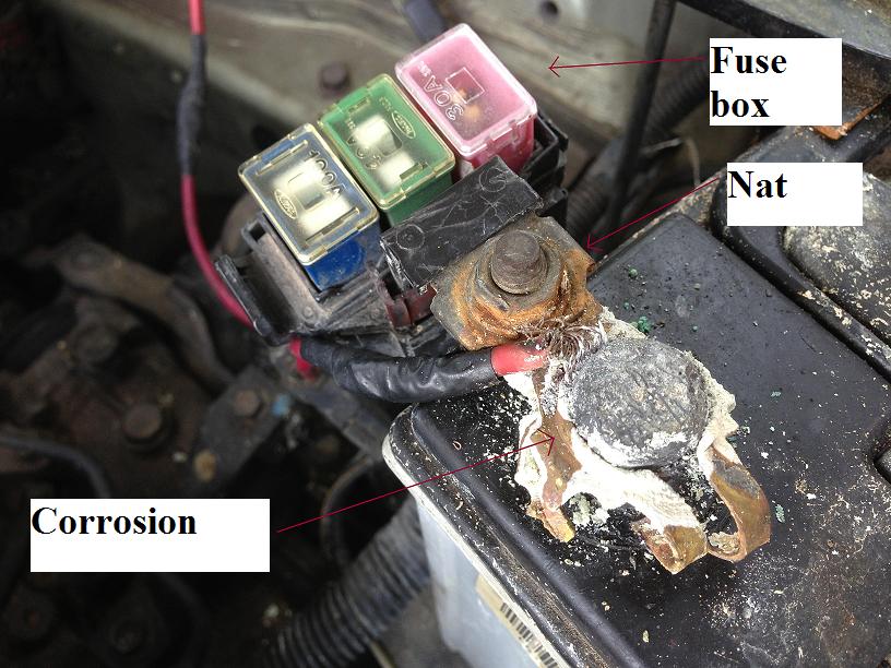

Sorry for the delay guys.Not online for few days.Here is the picture:
attachment.php
Ahaw:Im not sure since i never change the battery as i just bought it second hand 2 years ago.
I see a nut there. When unscrew can the fuse terminal be detached? If can, then attached the new terminal to this....

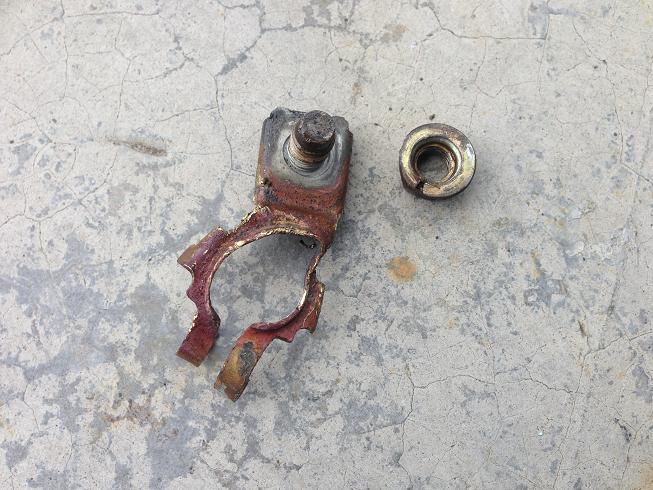

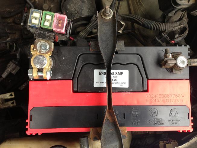

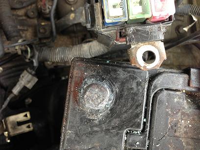

Finally its been solved.I bought a new MF batt and terminal.
Ended up some slight cut on my finger after battling to open the corroded screw :(
But im not satisfied with the battery terminal which looks like a normal terminal.Need to buy a good terminal later.
