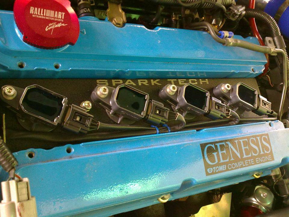

CDI can be used with all cars irregardless if using stock or aftermarket ecu. So long as the CDI box can take the signal from your igniter or ecu. What is not compatible is the coils. CDI will not work with certain coils with a build in ignitor. In d CT9A case, you will need to replace the coils to "dumb" COP type coils or get a compatible OEM coil from d pajero family to work. Mitsubishi is using wasted spark so a CDI box will work with it if it can take the signal. It is when you want to go to sequential and this is where you will need an ECU that can do this and to control timing and dwell time.
You OEM coil is just fine. I would only go COP if planning for CDI and sequential and with pencil coils. Just using COP alone may not offer much benefits. Again this depends on the coils. The pencil/AEM/sparktech type coils are better than you typical COP like the ones on car now. Just get the OEM one if your car is stock. Don't bother with the china made ones. Get original or OEM Types.
Evo's are well known to have ignition coil problem due to the heat of the engine bay. Oh, also check your CPS - cam position sensor. Did you relocate the battery and how is the grounding.

for Okada Plasmas, it does not work with standalone ECU. that's what i heard.
just in case if u change to standalone in future.

Friend, a faulty cps will cause misfire as well. But it will be very apparent across all rpm range. Your case is most probably coil related. No harm checking. The sparktech system is a very good unit albeit overpriced. I prefer HKS DLI if u retain the stock coil or if you go CDI. M&W or Dynatech's. But you will need new coils. A budget system will be some MSD tower coils. You can rewire them to work. They can be had for RM600-700. But you will also need some plug wires and depending on some people. The engine bay may look cluttered.
