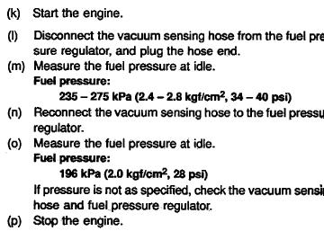

See the stock fuel pressure.
Stock Fuel Pressure at idle is 28psi or 1.93 Bar. You set at 3 bar... sure petrol smell lar.

As mentioned by levin1818, try lower your fpr pressure. Running rich, perhaps.
