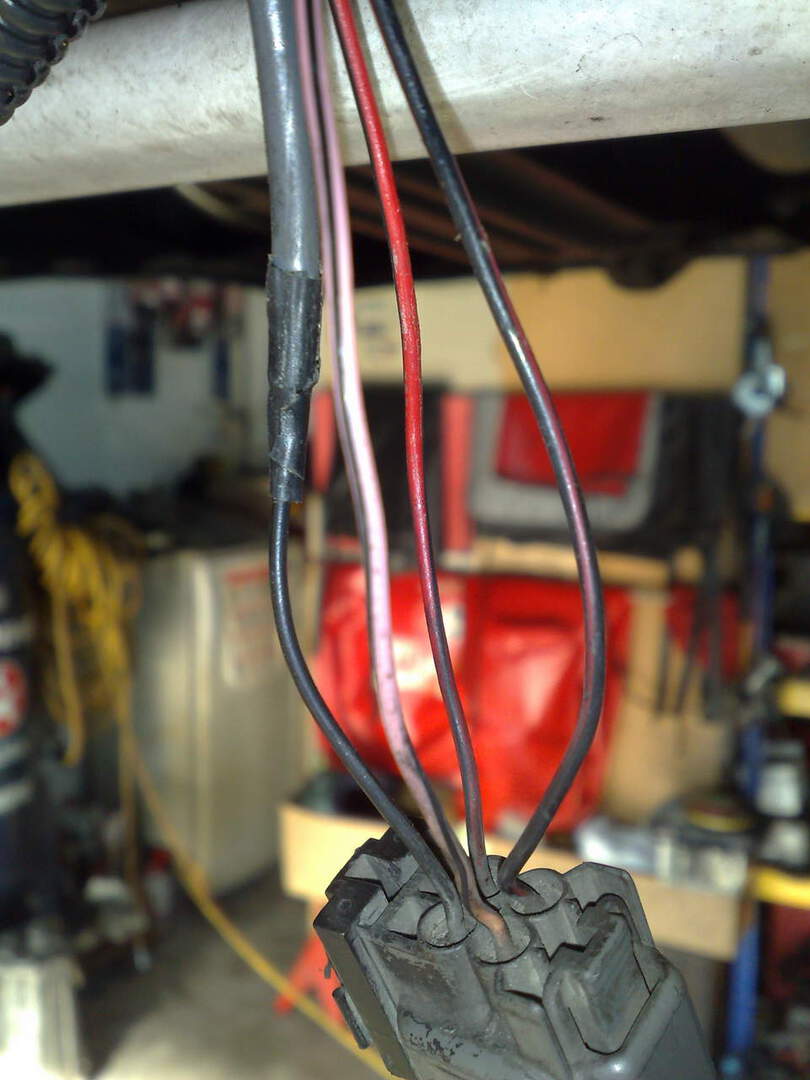

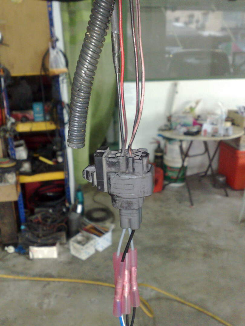

Hi all,
Pls help, I'm a bit confused coz I got myself a new O2 sensor and the wires are :-
1 white (signal earth)
1 blue (signal)
2 black (heater)
my current O2 svt stock has got :-
2 black
2 grey
before the socket, a totally different set of wire colours :-
1 Big grey wire join to a black wire to the socket
1 Pink black
1 Red Black
1 Black red
Can anyone teach me how to connect my new O2 sensor to the old wiring? Pics below..
Thanks in advance..:bawling:

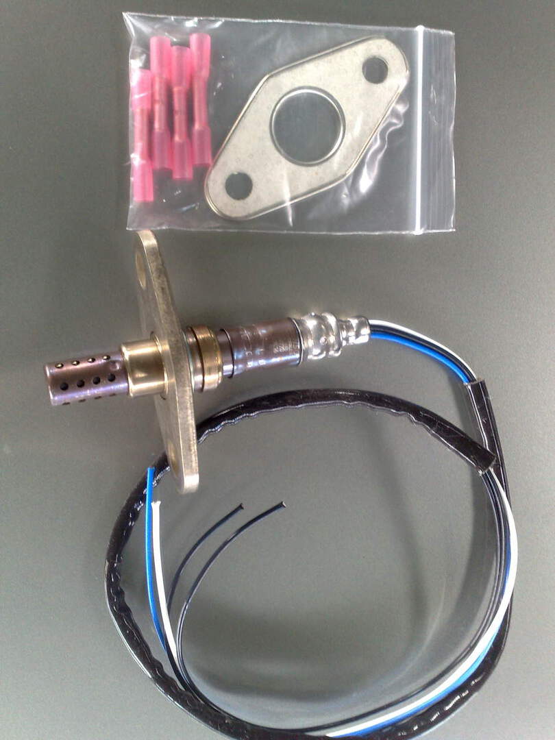

Hi Sifu wong,
Yes it was but since I bought the new O2 sensor, it only has :-
1 white
1 blue
2 black
So my questions is which wire from the harness goes to the new O2 sensor (pic below)? Thanks.

O2 --> Hardness --> ECU--> New O2
black --> pink black --> HT --> black
black
--> black red --> +12V (IG SW) --> black
grey
--> black/big grey --> OX --> White
grey
--> Red black --> OX+ --> Blue
For SVT, the ECU sense the low side signal (signal earth) of the O2 sensor.
Therefore, white wire should be connected to OX.

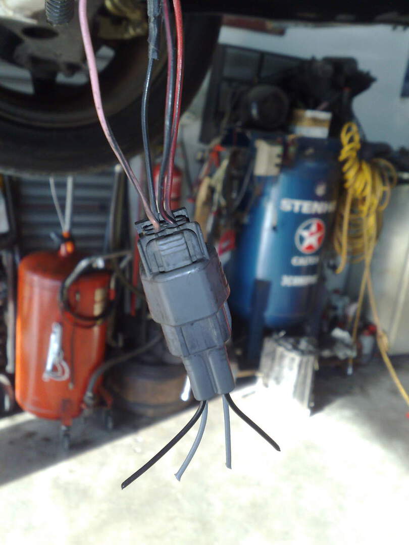

Here's some of the pin connection picture :
1 - grey -> black / thick grey
2 - grey -> red black
3 - black -> pink black
4 - black -> black red

But the pin orientation has something wrong le. Black/thick grey should go to pin no. 3 right?:biggrin:

Correct me if i'm wrong ler... :smokin:
SVT (O2 sensor) -> BT (harness)
1 - grey -> pink black
3 - black -> black / thick grey

SVT 02 sensor have 4 wires,the colors are
Pink black = Heater control - connected to ECU
Black red = +12V supply (IGN)
Black/thick grey = Sensor signal output to ECU
Red black= 1V voltage supply from ECU

Didn't know that it's this complicated and there was a difference in the O2 reading for svt and bt...well than I apologize for not informing earlier that I'm using a 5sp BT Ecu with SVT harness and just got the new O2 sensor. Previously using SVT O2 sensor.
This is the only info I got from the supplier of the O2 sensor..
black -> heater
black -> heater
blue -> signal (+)
white -> signal (-)
Thanks for all your comments!
black -> heater
black -> heater
blue -> signal (+)
white -> signal (-)
Then it is correct that Blue is OX and white is signal ground.Just connect it that way,i already mod your wiring to use BT O2 sensor.
