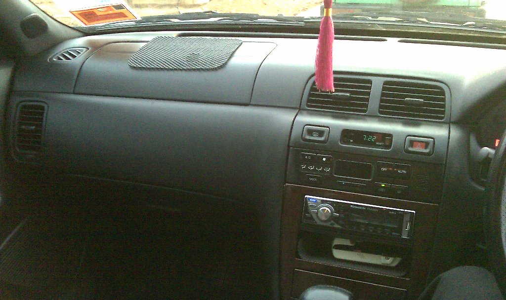

9.Whole dash board, with meter panels and center console
10.Steering and airbags (driver and passenger)

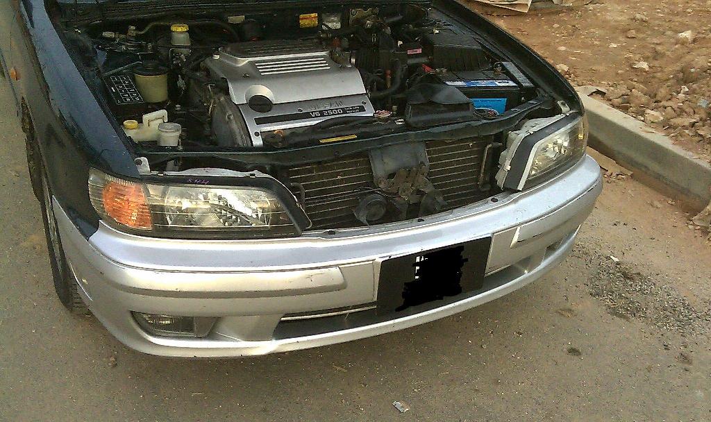

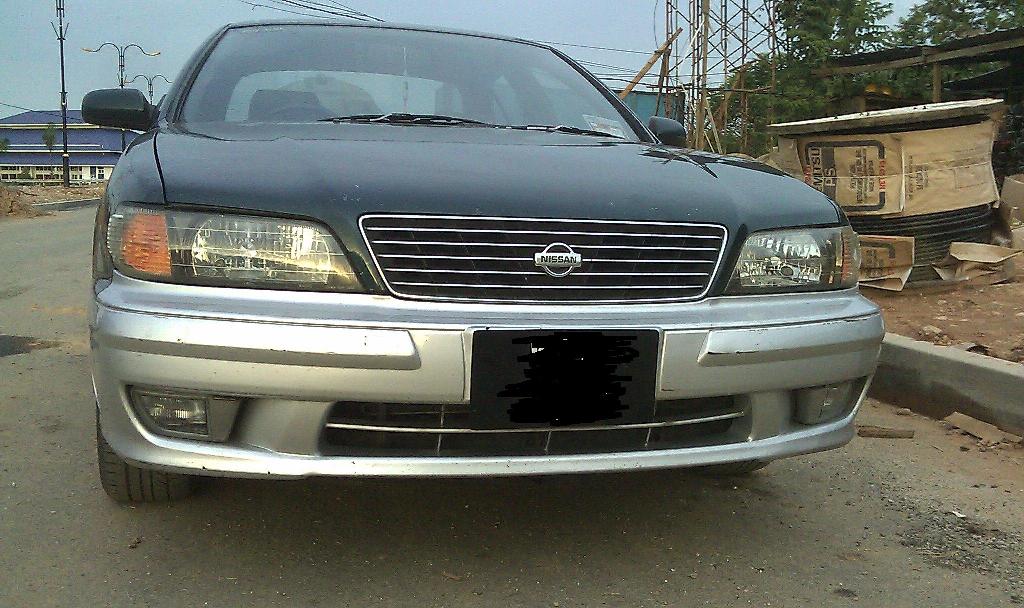

Below are some pics taken just now. The bumper and spotlight is actually taken from the halfcut, my ori one cracked after hitting dog last time.

Front with head lamp and bumper from halfcut. Loves the smoked headlamp
Another front view

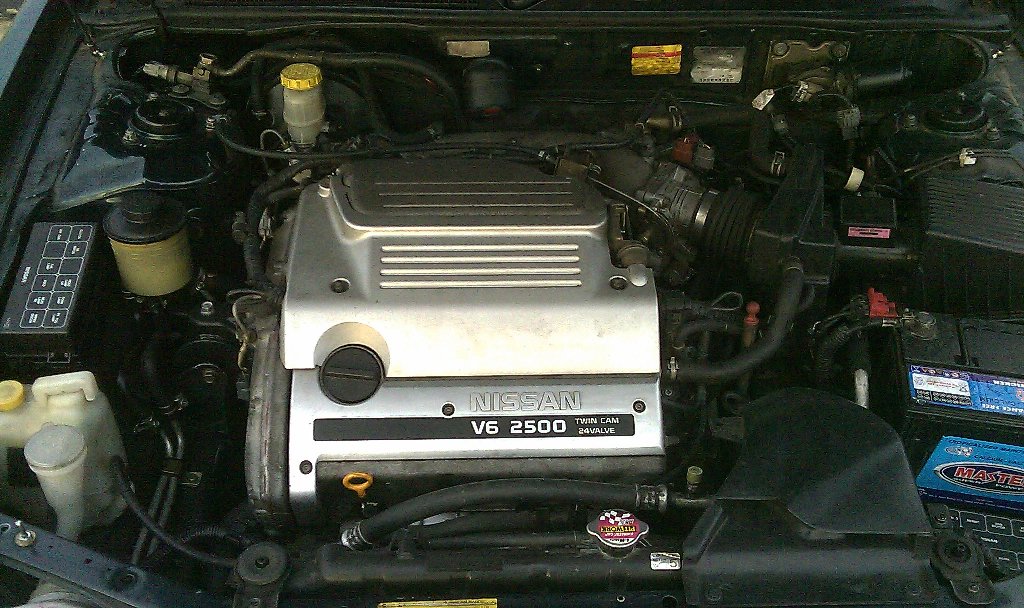

Engine bay with VQ25, pretty much like VQ30

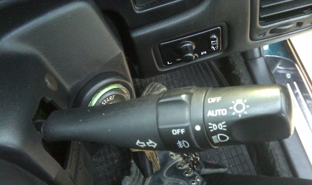

"Auto" light switch, only automatically switches light off after off engine, doesnt function as light sensor as claimed by the foremen.

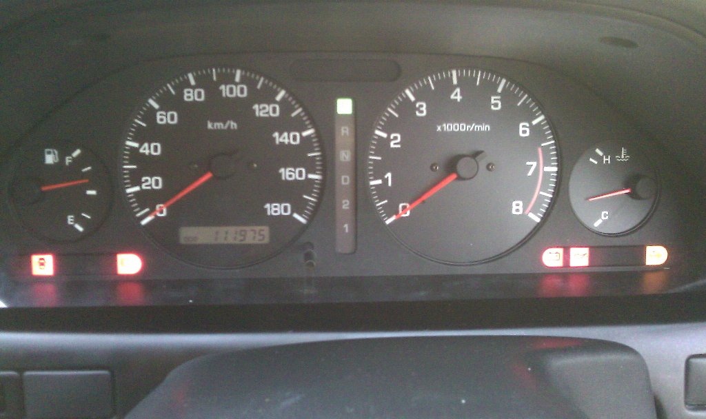

Jap spec meter panel with ~111k km on odometer. Gear indicator is there as opposed to blank strip in 30GV

how does your auto lamp switch work? or is it working?
if the engine is register, the roadtax will sure reduce.
Auto lamp will sure work, the sensor is on the dash board, the right sensor is for light (driver seat), left is for Auto A/C.
Planning to do all the registration in two weeks time only, now busy with works. If not mistaken, road tax for VQ25 shud be 8xx only, compared to 21xx of VQ30
I dint notice any sensor on the right hand side of dashboard. Is it also under the windscreen? The auto light switch is not fully functioning, except that it'll turn on when engine is on, and turn off when engine off, that's all for now. Maybe incomplete wiring issues.
I'm planning to replace the meter marking, from the Japan 180km/h one to Malaysia's 260km/h one. Cos I noticed the needle still pointing the speed as in my old 260km/h meter. Anyone has done this before?
yours is digital, i am not sure if it will work. cause if you dismental the back of the speed meter, there is some dip switch which is already solder, the setting maybe is universal for mph, kmh and 260 to 180, difference dip switch setting will give difference setting. maybe you can try compare to your 260km meter dip switch and try use the same setting.
For auto light, yes it will off when your engine is off and door open. when is day light engine on, the light will not on. it only on when it go dark. there is one sensor on the right side of the dashbord, if you don't see that mean the sensor is missing so the auto light will think is always dark and always on loh. I know cause i am using auto light.

i've changed the whole meter cluster (not the marking sticker) to the japan model (from 260 change to 180). i did compared both the 260 and 180 meter on the speedo reading, both have the exact same reading compared using a GPS.
try not the replace the meter marking. it will be very inaccurate then as the speed sensor is inside the meter cluster.
therefore, if you are doing 110km/h on the 180 meter and doing 110km/h on the 260 meter, you are actually doing 110km/h. (provided the rim and tire size are stock :)
If you dismantle the meter cluster, inside the 180 and 260 are identical components. the only difference is the dip switch setting. Compare the dip switch, unsolder the 180 dip switch setting and solder the same exact location of the 260 dip switch setting, the meter will go with 260km/h. Can give it a try, but try at your own risk. I have one that made it from 180 - 260, is in my spare parts box. yet to test it.
VT-Ten, I counter checked GPS, it's the Japan meter not working correctly. It's reading 90 when I'm doing 110.
Weikee, can u just snap a pic of the dip switch? Need to solder ka? sounds quite difficult...
Sorry, is all assemble back, is a pain to take out the needle without snapping the spring. So I won't want to take it out again.
If you have the original 260, just take it out can compare. You need to solder the dip switch.
I find A32, and B14 meter are off by 7 to 8%. last time my SR16 meter is also off by 8-9%, (SR16 from N15 are the same family with B14)
