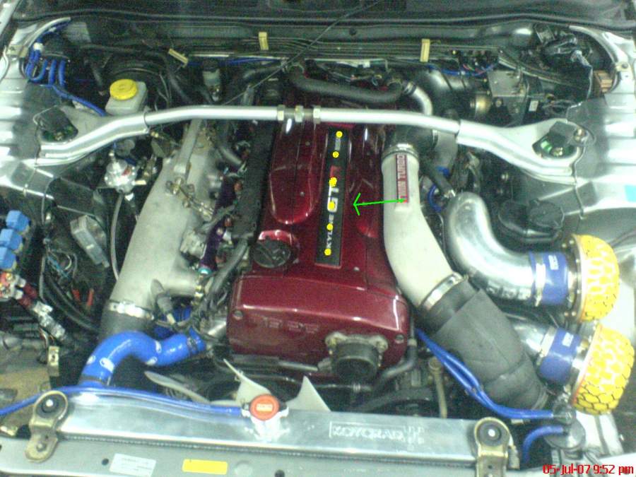

:nurse: the coil will be under the nissan logo cover!!!
:biggrin: or where the plug is, the coil just on top it!!!!
example: on 6inline!
sorry that i dont have the v6 pic with me!
