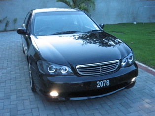

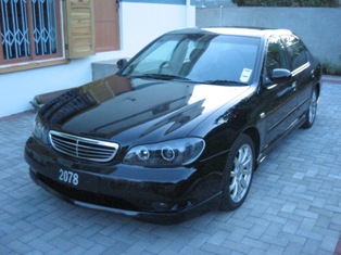

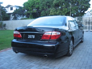

helping a new member to post his ride: Ming Chen - A33
