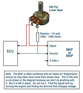

This is the simple AF ratio controller to tune the Maf sensor.
Another one is volochip it control overall car engine sensor on fuel control include MAP/MAF sensor as well as the O2 sensor

the throttle control which advertises fuel saving is actually just another gadget that makes another fool part with their money.
the gadget actually just amplifies your throttle response, so in return no saving is achieved
