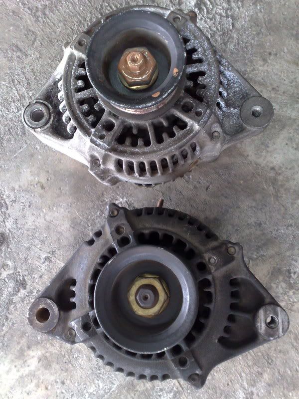

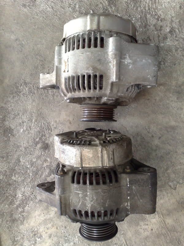

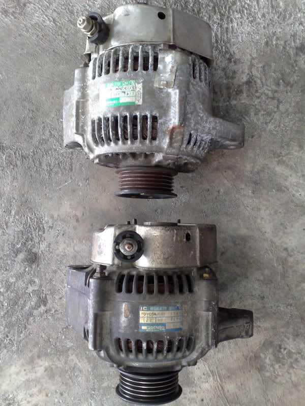

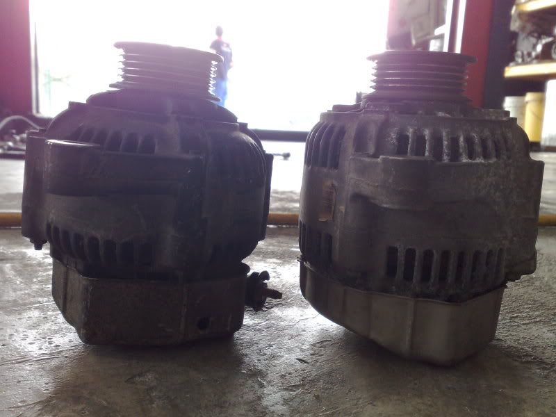

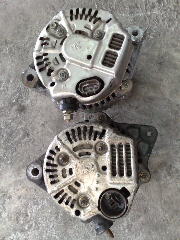

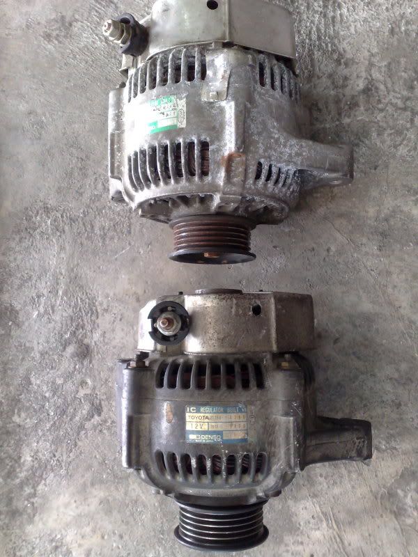

bought it during the weekend and installed it. it's from a 5S-FE 2.2 engine.. it's a direct fit and I learnt that it's a bitch to take out an alternator from a AE101 20v! They should have just put it on top of the compressor like the 4afe and the 5S engines!!! hehe..

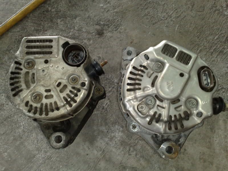

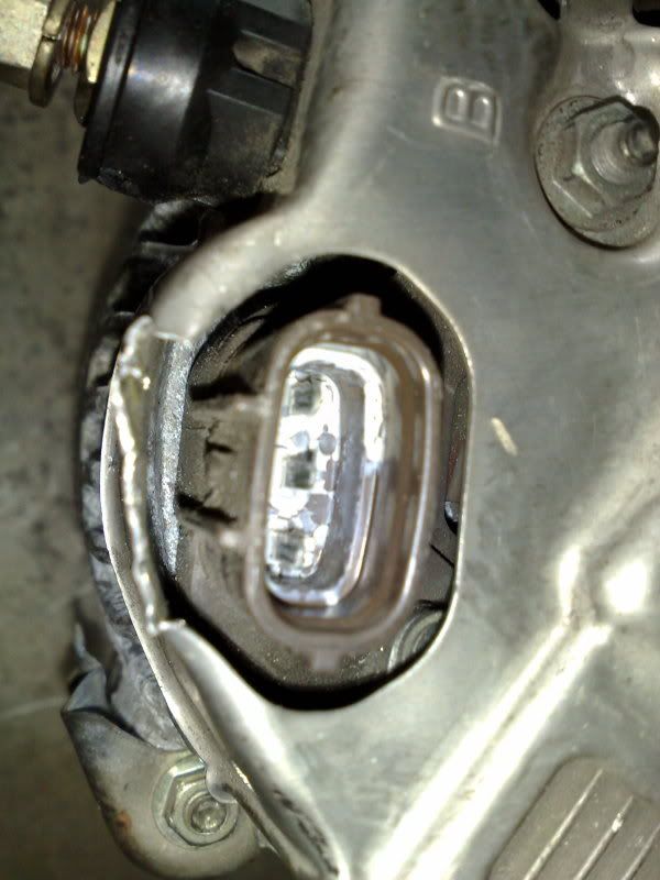

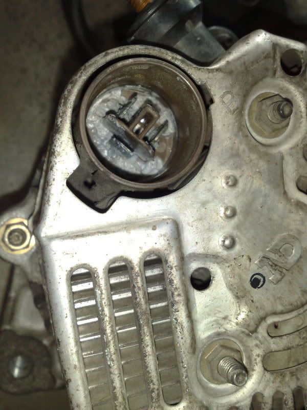

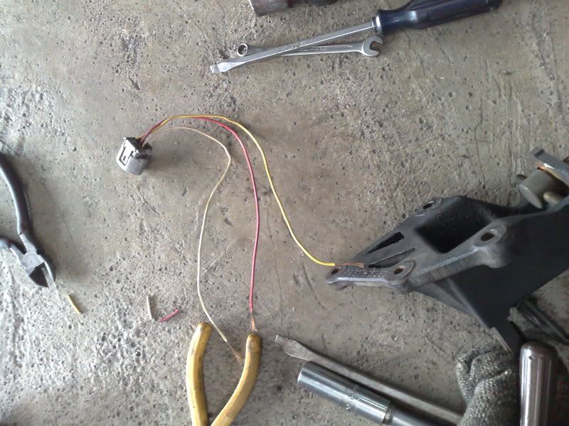

anyway, no mod done but the socket was different..it's just a matter of joining the old wires to the new socket..very straight forward coz the colour of the wires are the same. See pics la..

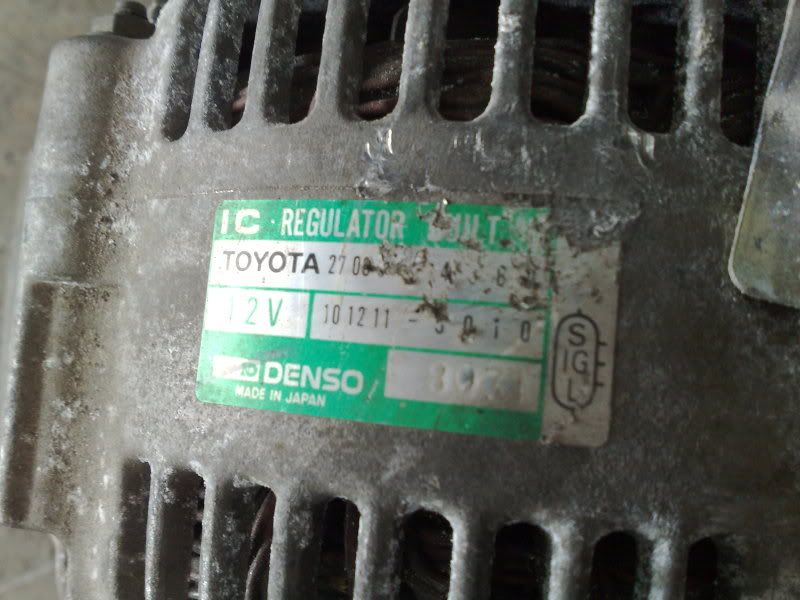

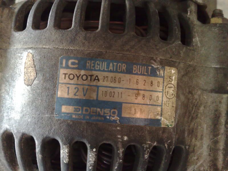

The one with the blue tab is from the 4age svt (70amp)..green tab from the 5S (80apm)
i think you meant alternator and not generator rite? all newer alternators comes with a regulator.. it sits below the heat sink area...the belang2 part which looks like ur pc's processor heat sink. it allows constant power to charge the battery..the bigger the amp the bigger the battery..so easily put, if you're using an alternator from a 5S engine, just make sure that you're using the same type battery that comes stock with the car..
