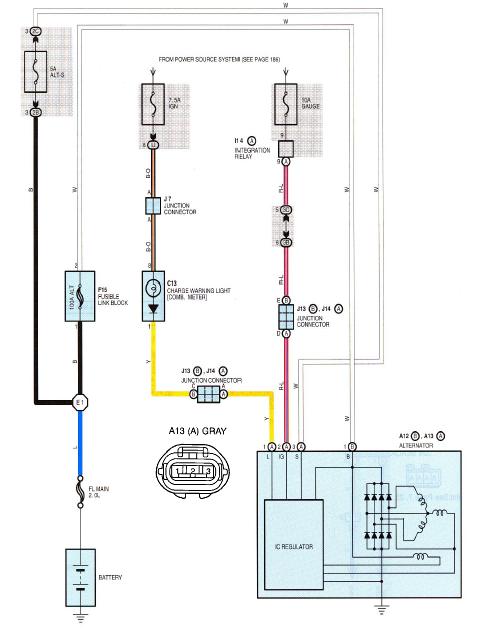

The socket to the alternator on my car had disintegrated and would like to ask to help if any of you 4axx engine owners take a peek at your engine and tell me the position of these wires from top to bottom. It's a 4AFE engine.
A couple of questions incl above:
1. Order of wire from top to bottom -- I think it's yellow on top, then black/red, and lastly white. Can anyone help me confirm this? I already burnt the fuse and don't want to short circuit anything else.
2. Is there any relay connected to the alternator? I heard "click-click" sound from the fuse box when the wires touched -- I think this is why the fuse got burnt. Could not fund any relay indicating alternator but there's a fuse with "ALT 100A" which I'm guessing is "Alternator 100amp".
Appreciate your help. Thanks!
Here u go... follow the plug position 123...
attachment.php
Thanks bro! That's exactly what I need!
UPDATE: Problem solved with that diagram. Also replaced 5A alternator fuse. Have not test driven far but so far so good.
