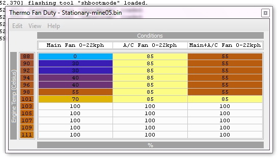

tested. it is controlled by ecu and can be changed.
test was done on stationary condition, warmed up the engine until around 88c (which is the lowest threshold on the ecu for the fan settings).
my stock fan setting in the ecu only will run the fan once the temp hit 94c, which was correct, neither the fan were moving around 88c.
then i changed the settings to run the fan once the temp hit 88c, and confirmed; the fans were moving.
Ah Wah told me I need to change a fan controller to switch the fan on at a lower tempreture too...
