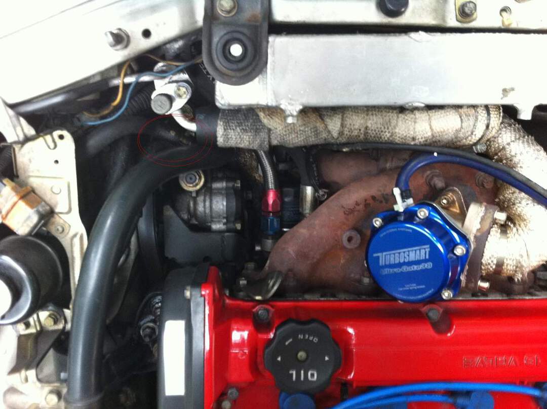

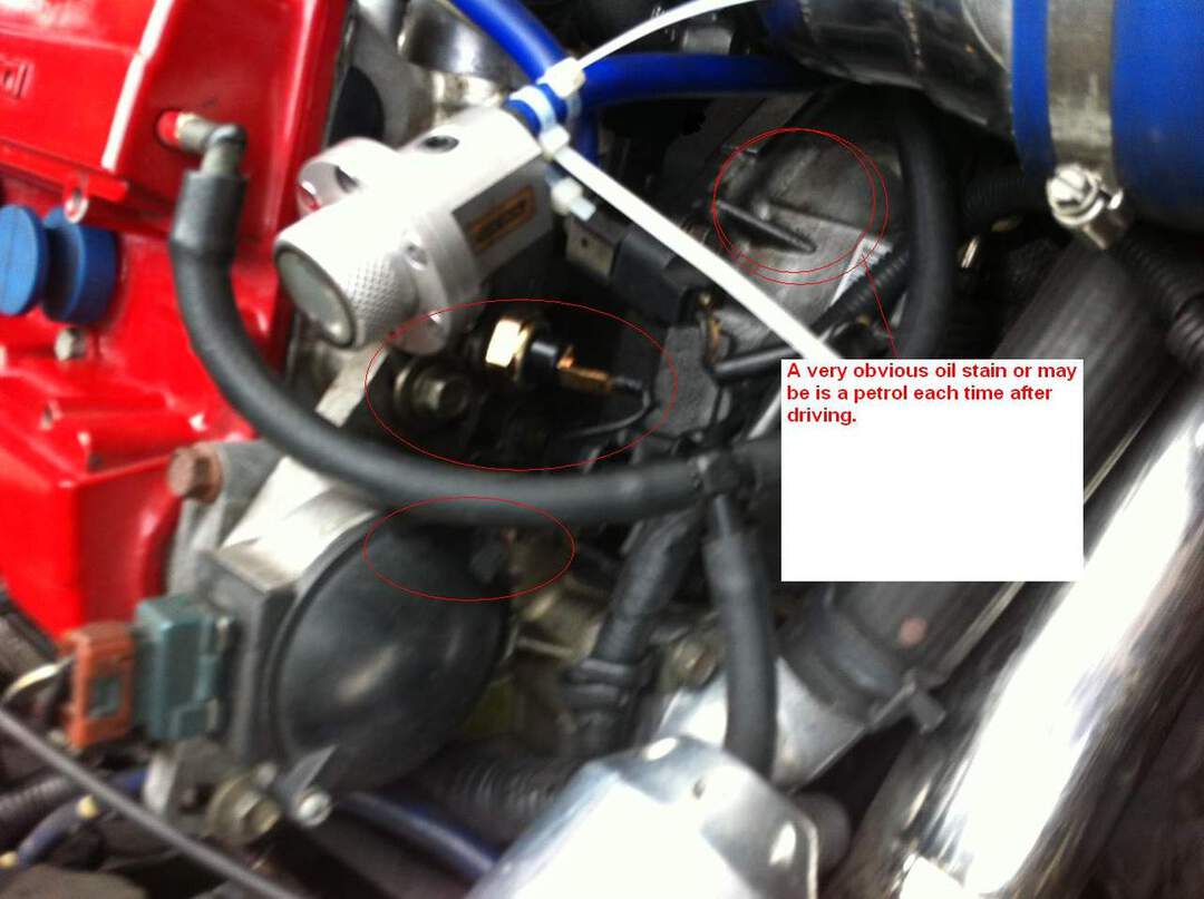

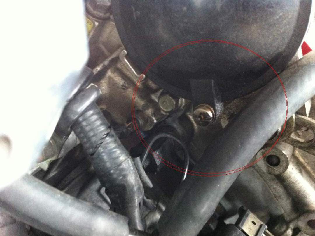

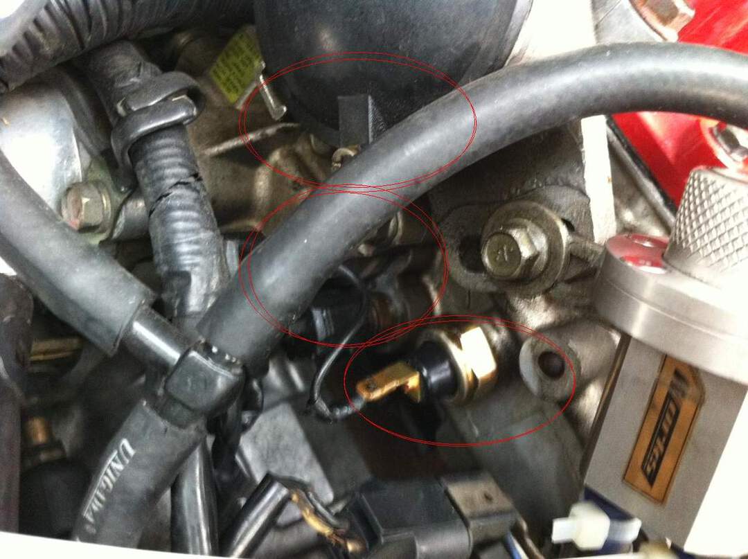

Hi Guys,
I got a problem here, there is a oil or may be fuel leaking at my engine bay.
Photo attached. Engine - 4g93t
- Can't press hard on the fuel pedal, car will jerk, it happen all the time, 1st gear and turbo cant kick in anymore because of this.
- Below 4k rpm , lag of power - only soft press on fuel pedal is allowed. After 4k rpm, can feel bit of response when on pedal. Normal drive
- Fuel consumption very high - Full tank can go less than 230km ( Normal drive only coz turbo cant kick in )
- Petrol smell when i open my engine bay
- Engine getting hot easily
- Again, engine light on.

4g92mivec,
1st photo is your oil press sensor. Leaking from there is engine oil. Use teflon tape kawtim leaking.
2nd photo still the same. Oil press sensor. The other smaller sensor is water temp sensor to meter cluster.
3rd photo is power steering. Either o-ring or washer needed to be replaced. If from hose, change power steering hose. If re-clam new hose make sure the one-way valve is re-used. Otherwise power steering make noise when you fully turn your steering wheel. Not sure if 4g93 got this.. but 100% honda got this valve.
4th photo is crank angle sensor. (just change o-ring settle leaking problem)
jerking and bogging is not the same i am telling you.
if jerking maybe fuel pump going to die... not enough fuel is supplied to the engine. injector jam..air flow unit or electrical socket faulty.
bogging (press gas pedal 100% but RPM like not going up-misfire at certain RPM) over-fueling or spark plug cable and or spark plug already die.
check engine light ON = have to see what error code before further repair.
