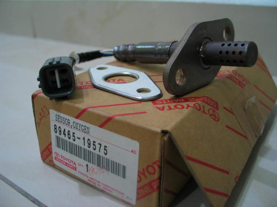

The O2 sensor that i bought is for AE101. Part number is (89465-19575). Therefore if 96' and above is AE111, then its a bit not too right le. Is anyone out there driving 1995 AE101? Or 94, or 93? Pls advice do they have O2 sensor? Thanks

The O2 sensor that i bought is for AE101. Part number is (89465-19575). If lets say 96 and above is AE111, then why this o2 sensor part number is for AE101? Pls help............. confused. This o2 sensor is stated in the AE101 parts books............
maybe ur sensor ae101 for 4age engine.
Bump: 4efe o2 sensor 1996 model (89465-12450). ohm meas reading 14.2ohm same 4age bt o2 sensor resistance.
huuu...why your part number is different ?
maybe interchangeable :D
here some info :
89465-19575 - yours...not sure which model use it...huuuu
89465-12280 - 4AFE
89465-19175 - 4AGE 16V (not sure small n big port interchangeable, supposely can i think)
89465-19495 or 89465-12290 (SVT)
89465-19685 - 4AGE 20V (BT)

Here is the photo attached of the O2 sensor.Its brand new. Those who interested to buy, pls PM me. Thanks
