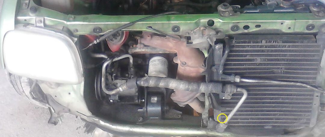

Lol .. yesterday's meet didnt happen. So I spent the evening flushing a kancil's radiator and replacing the wira's power window bracket.
Nope but can't help wonder which genius at Perodua designed the radiator's release cock right next to the exhaust header
Isnt that a Daihatsu inside?
attachment.php
Not sure how Daihatsu does it but on a Kancil, it's right behind that yellow spot. Try sticking your hand under the car to unscrew that drain plug. Sure kena the exhaust. Normally people remove top hose to flush the radiator but I was concerned about damaging that hose

attachment.php
Actually removing the top hose is better and it is stronger than the small release plug. If you can damage the hose it also means the hose also about time dy. In fact, long ago I always change by releasing from the plastic plug but one time, it being old the plug broke instead, so from now on I release from top hose....:driver:

Can share the steps on flushing the kancil radiator? Mine once opened can see brown water which looks like karat.
Remove top hose loh! Kancil try not to touch those linkages, T joints. Saw at mechanic place, got one kancil those joints very fragile....:smokin:
Kancil got T joints meh, last time I check my 660 oni rad to engine than engine to rad that's all.

Flush until clean then only pour in coolant right?
try read here 1st
http://www.zerotohundred.com/newforums/car-care/430512-how-to-perform-a-radiator-flush.html
Personally, I will fill it with just plain water & run it for the next few days. Then open radiator cap and if water is murky, flush once more. Repeat steps until the water remains clear. Then only will I add coolant. Btw, that brown water comes from your engine block. If allowed to persist, it eventually clogs your radiator.
