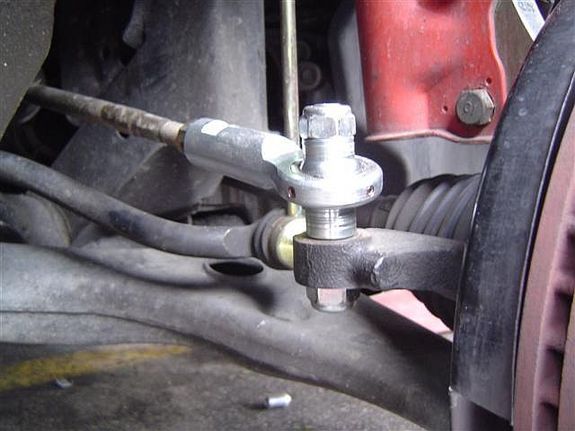

option 3 i think is like the R3 Bump Steer Kit photo attached.
it is exposed to dust/sand and can last about 12 months before need to change the bearing after it worn out.

should go for this inverted set-up,im done the same on my car last time.steering response behaved differently too.
so this will eliminate the issue of super positive toe whenever we wanna adjust the front camber setting lower than the OEM spec, am i right? i have this problem of my toe in going +3 deg whenever i tweak the camber beyond -1.5 deg. in that case i would go for the proposed cheaper solution by Ali bulala than buying this from the states..

Good News GUYS... the picture that i post are a maintenance type of tie rod and too short. the pillow ball need to be regrease and worn out easily. if the pillow ball kong need to buy a whole tie rod end. so, the mechanic said that he going to custom from billet steel and use high quality spherical bearing for our car. It gonna be better quality. so option 3 la.. the price should be cheaper than the price of the tie rod end which lightningfield posthttp://typeoneracing.com/catalog/product.php?productid=1293&cat=104&page=1. so. the price should be cheaper than Rm700 and the quality are much better than the T1R inverted tie rod end. We should get the final price maybe by this friday. Thanks and be patient....

i will try to get cheaper. i think more quantity will help reduce the price. btw. what i know that the T1R inverted tie rod much more expensive. price of it around 500+ not include shipping and tax to malaysia. the T1R are no good in quality. there been complains about the T1R tie rod. BTW. if want same quality as the T1R it should be cheaper. Our custom should be a lot nicer and higher quality with same price or cheaper than it. anyway. i will try get cheaper price. i dont know the what the prototype or final product will look like yet. i will try to get it cheaper and earlier. thanks.

I seen a few dc5 track car with inverted tie rod already. Hope that our custom tie rod will hv better quality than the aftermarket one. Still waiting for the prototype.
