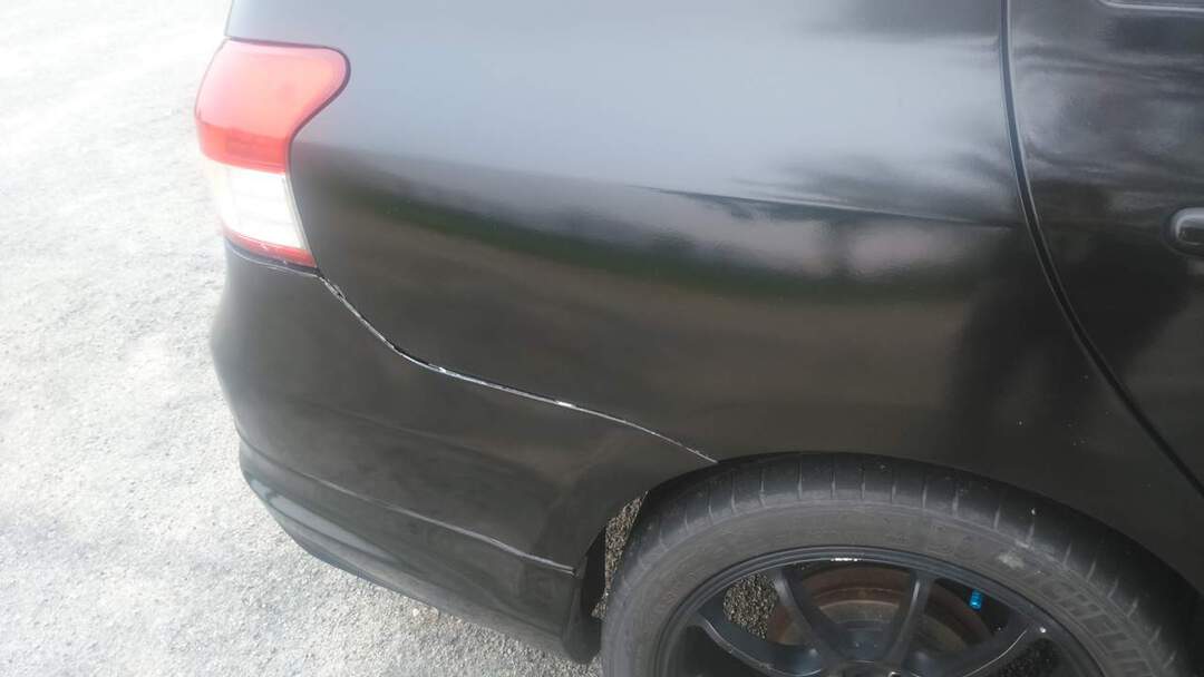

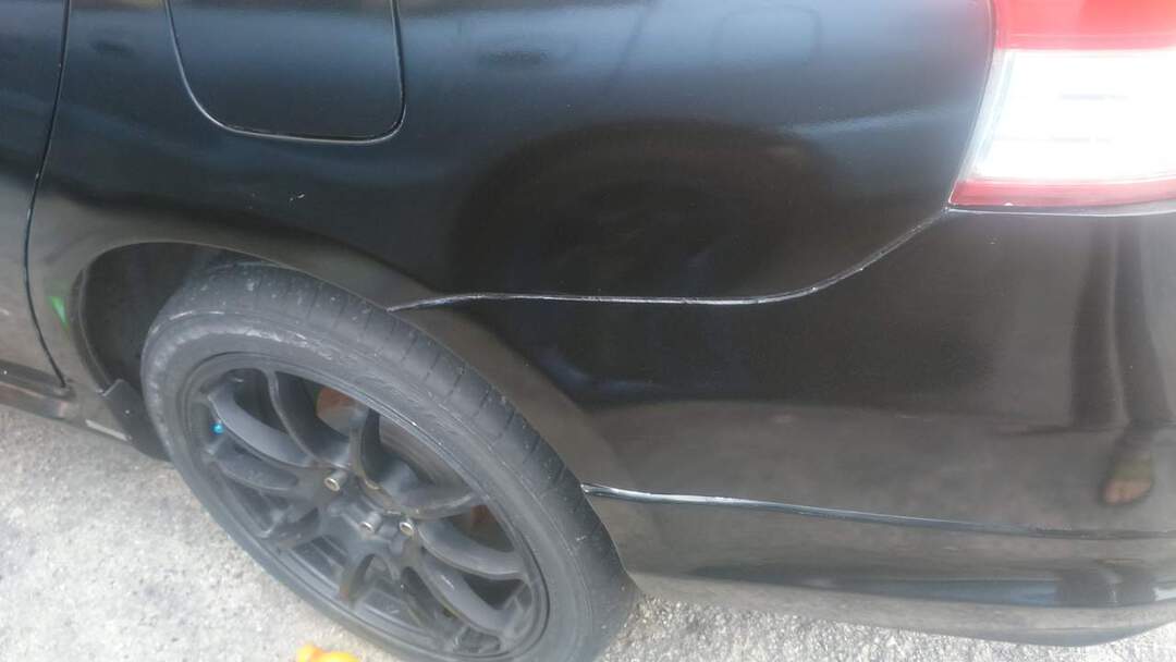

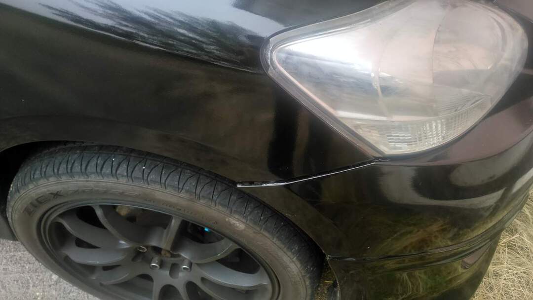

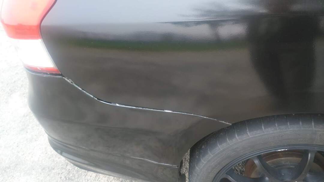

Please be carefull before u send ur car for a paint job..stay away from this car paint shop..
1.no sanding before applying new paint
2.no primer!
3.only 1 layer colour on top old clearcoat!
4. 1 layer clearcoat!
5. Wiring all gone not attached together
6. Plate number all fallen
7. Window wisor fallen
8. No body dent repair!
9 orange peel paint the whole car!

If u see carefully at the black waja u know its low quality black paint..and cant see any sand paper on floor,not even wash your car before paint,good quality needs good prep and machines,he has no reading on his compressor and also the spray hose,no wonder u have "orange peel" paint on your whole car the pressure is not correct..
