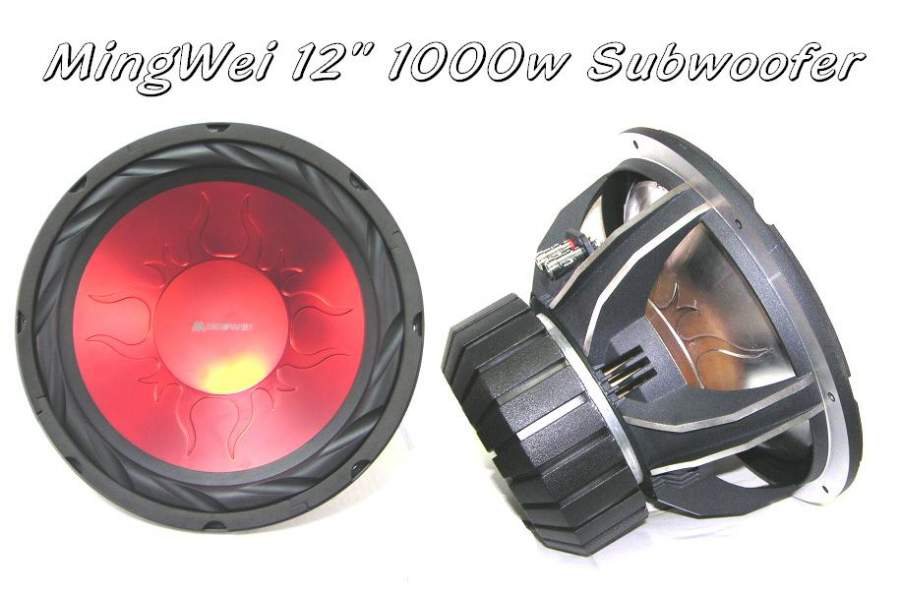

if the sub is 2 ohm..n can up to 1000w max power,
so the amp probably need 1000w power above??
this amp suit the sub or not?

what is the sub specs? single or double voice coil, how many ohms?
from the amp specs, u will need either:
-400W single voice coil 4ohm sub, or
-600W double voice coil 4ohm sub (wired in parallel), or
-1000W double voice coil 2ohm sub (wired in parallel), or
-400W double voice coil 2ohm sub (wired in series)

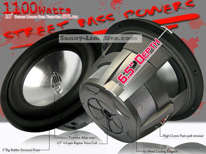

i found this. boschmann sub. got detail info.
n i look the actual sub liao.
damn heavy.. the acc shop guy said 1 enough. if 2,, wan blow bonnet ah.
tis sub can pakai or not ?
donno the amp can tahan tis sub or not. got 2 +/- wire terminal . can set as 2 ohm.
the guy told me.
the specs of the sub doesnt clearly say what power RMS it needs, just says 1100W power handling, which i assume is peak power, maybe its around 400-500W rms
anyway its a dvc 4ohm sub, so u can wire it to 2ohm via parallel wiring. u will get 600W from your amp, which i assume should be ok for this sub
