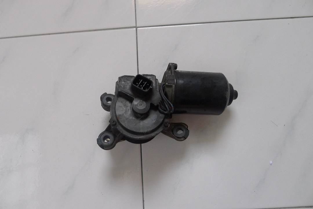

Is this the wiper motor you're referring to?? I'm selling it for RM80 including postage.
It's taken out from my AE100 (not halfcut item) cos when i swap engine, mechanic install everything from the halfcut.
PM me or call 0128831808 if interested.
