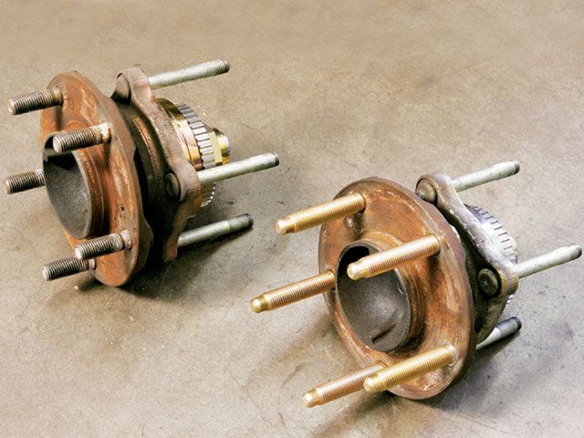

Better to just change the lug studs to longer ones.....:driver:
http://www.zerotohundred.com/newforums/attachment.php?attachmentid=565147&stc=1&d=1497692689

That is why you need longer studs. In my picture I am showing you the short and long studs. With the long studs then you have more area to screw onto. 3 rotations is too little.....:driver:
