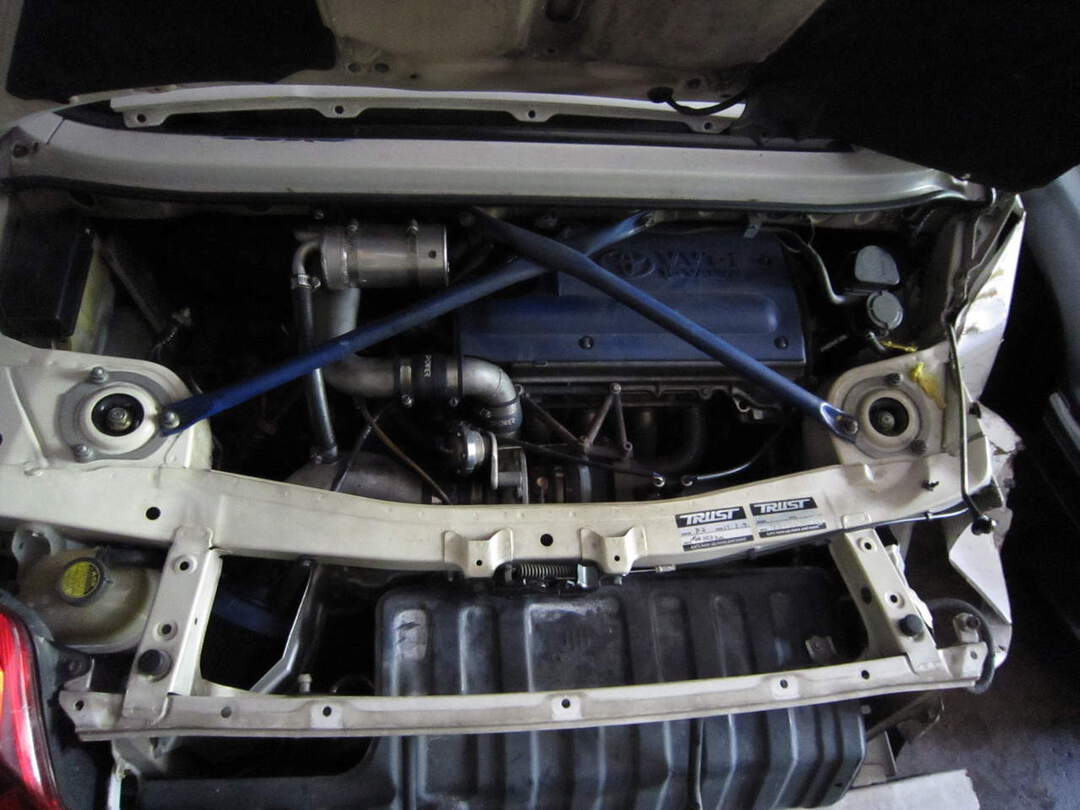

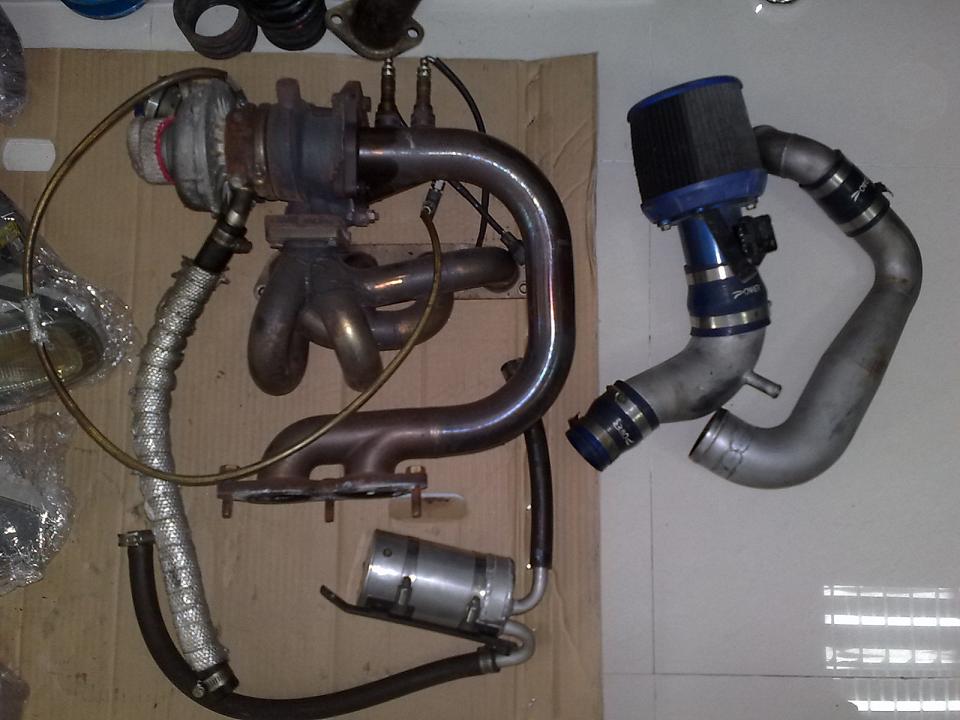

i hav a 1ZZ engine with turbo for sale....also 6speed manual conversion kit if interested.....
