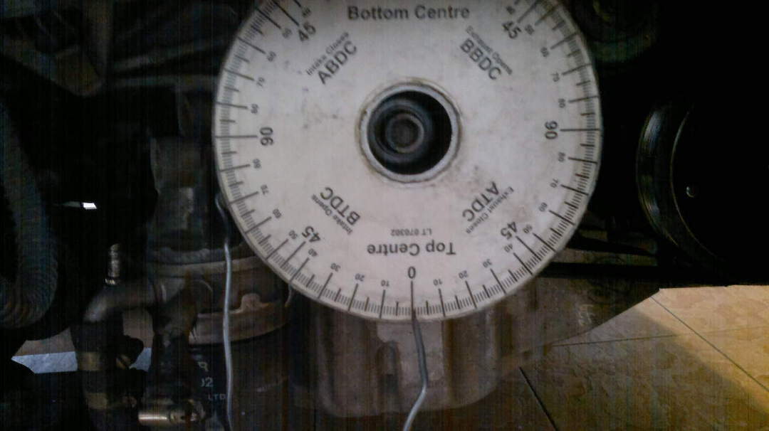

now, after i did something to the cooling system :
cruising day / night : 83-85 degrees C ( night time drops to 78 degrees C depending on weather )

I have yet to install oil temp gauge. still have not solve how to relocate the filter lol
Oh I tot mine is very high cos my friend's gen2 1.6a ard 85-90 only! I jus used a adaptor in between e oil filter n engine. Using a shorter oil filter too.
I modified some stuff, so using a short filter makes oil filter change a 10 minutes job lol..
im running cooled water to the oil filter. hence, no room for adapter.. :(

Yup, DIY.
When we meet, i will tell u how its done. not really complicated..not really done neatly yet, but to me it works la..

Whoo nice!! I assume you are using the engine coolant to cool the oil? Cause I remember the Toyota Celica ST185 is also using a similar concept. IT has a water oil coolant. There is an outlet from the engine which will pipe coolant to the oil cooler and back to the radiator.
Exactly.
The outlet from radiator directly to the oil filter, and then joins back to the cylinder head.
It took me 2-3 days to finish this project..DIY mah.. :biggrin:

save the trouble and headache, get the air-to-oil cooler. saves you alot of time and labor.
mind you, you need to remove the intake manifold to reach the water hose...then find space to fit two hoses near the block, just missing the drive shaft.
and also, oil filter change is somewhat a hassle with this setup :thefinger:
