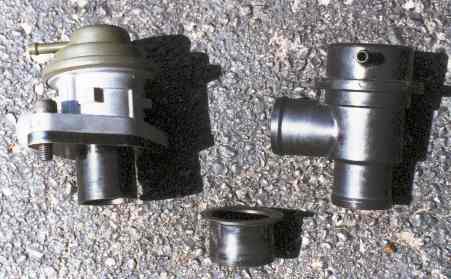

when u let go ur throthle, ur throthle plate closes , ur boost goes to vacuum, the excess air needs to be vented out to atmo or reroute back to compressor inlet, if you do not let the air out, where can it go ? u have already closed ur throthle plate , hehe
thts the reason u need a blow off or bypass valve
diffrence between stock bypass valve and greddy or etc is that
the aftermarket ones hold more higher boost
stock plastic ones will start leaking out above 0.8~bar

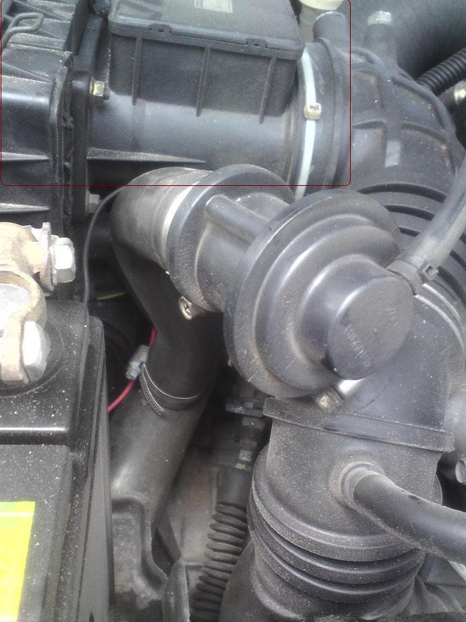

1. Evo 7 bypass valve sits between TB and I/C;
2. Evo 1 bypass valve sits between AFM and compressor (see attached pic).

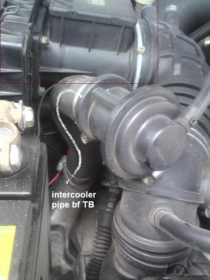

no laa brooo, adui
if u see ur picture properly, the bottom of the bypass valve connects to the intercooler piping
the top part where air comes out from the bypassvalve is rerouted back to turbo compressor inlet

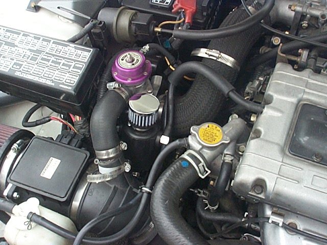

nah hw a stock bypass looks like, the bottom part goes to intercooler piping, sideways one goes to AFM, thts wht we call "re-reroute"
this is a picture if the bypassvalve is replaced with a greddy

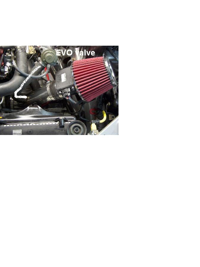

Bump: nah attached a evo , it also connects it outlet of the valve to AFM, same as older evo
garrett is correct :D
