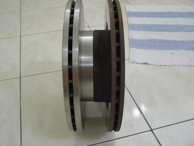

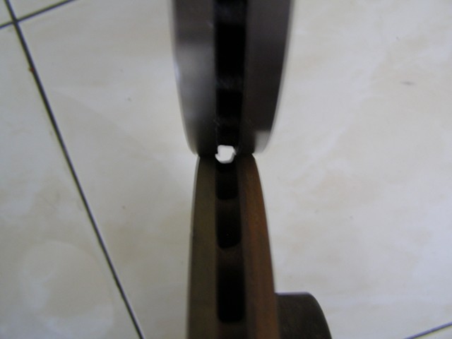

Like you said bro, 3.0L disc are thicker and firmer. Feels better during high speed braking . More confidence mah.
