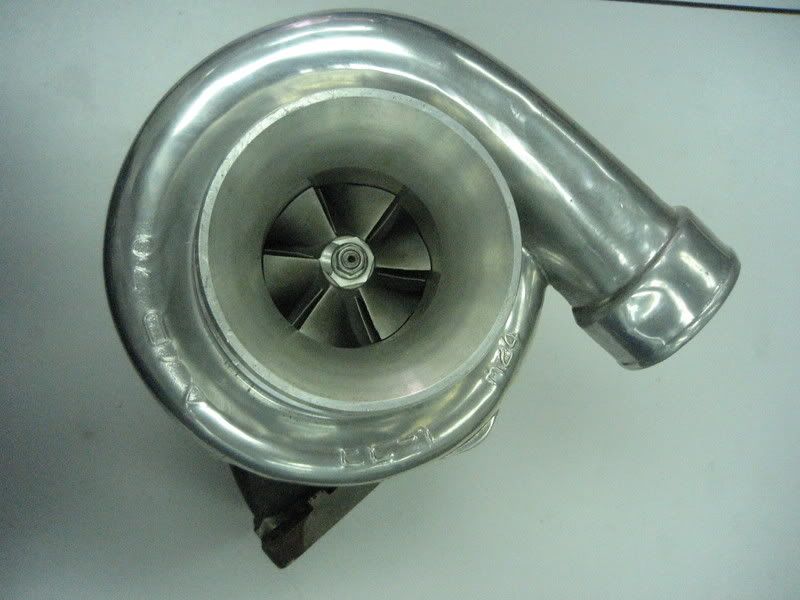

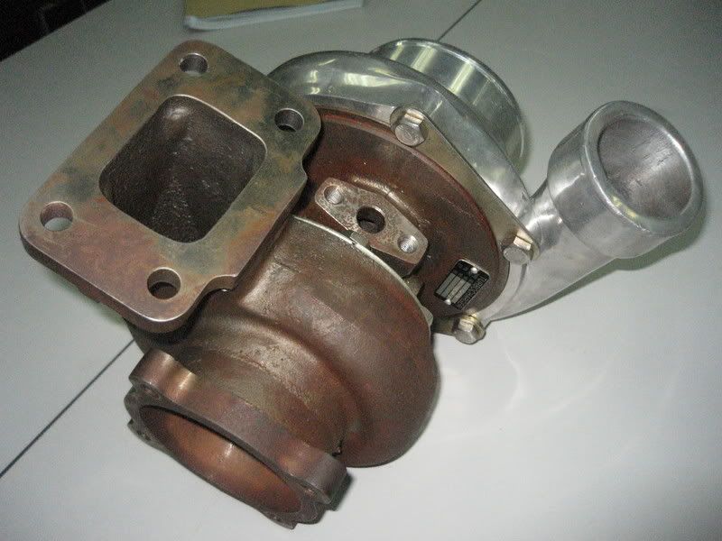

Below are pictures of the IMITATION turbo found and complained by customers.

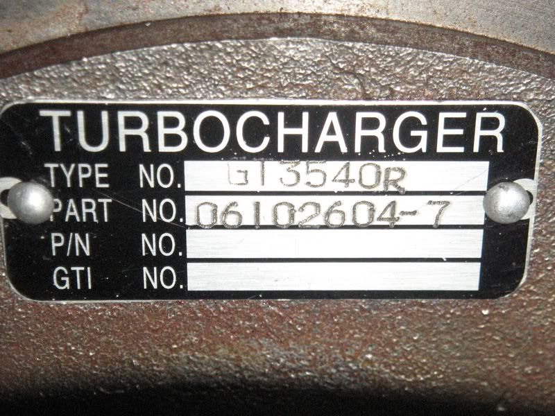

1. No Garrett name plate
2. Not Garrett single cartridge ball bearing design, they are using standard 2 piece ball bearing (not able to withstand high speed and high temperature)

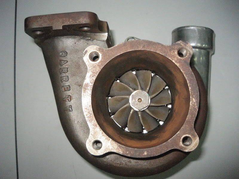

3. Poor casting on Turbine housings
4. Rough bearing sounds. (we have the video to prove it)

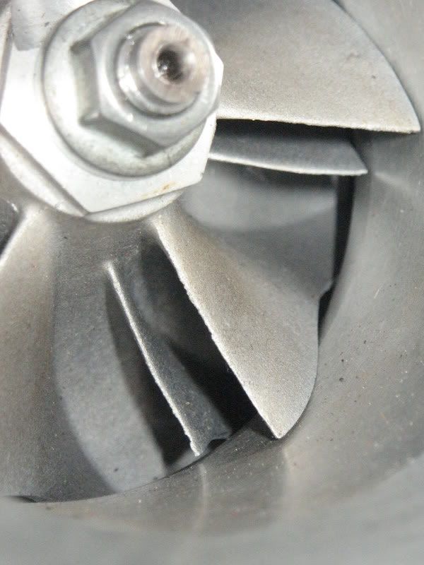

5. Rough and Poor Compressor Wheel designs.
